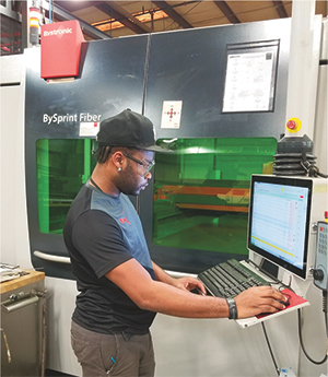

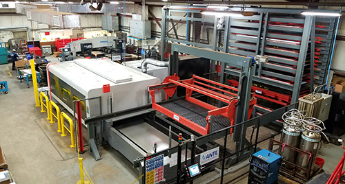

In its ongoing effort to handle entire projects for its customers, and against the backdrop of increased stamping operations, in late-2016 Decimal opted for the Bystronic BySprint fiber-laser-cutting machine with a 5 by 10-ft. cutting table, augmenting its existing laser cutter, a 2500-W CO2 machine. Antil Robotics and Automation provided the material-handling equipment as well as integration.
“The new fiber-laser machine and tower unit weren’t just needs, they were necessities in order to survive in this business,” explains Alan. “We need to be on the cutting edge of technology and we can’t lose out to another company that cuts five times as quickly as we can. This machine brings that faster cutting capability inhouse here at Decimal.”
The BySprint provides high-volume part production and high cutting quality for thin to medium-thick ferrous and nonferrous sheetmetal, according to Bystronic officials, who note its low operating cost due to minimal energy requirements and no requirement for laser gas.

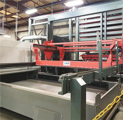

The Antil automated tower warehouse enables the laser-cutting machine to run lights-out, and its compact design fit snugly adjacent to the Bystronic equipment on Decimal’s shop floor.
“Given the size of this investment, we need to keep the fiber-laser machine running,” Alan says. “With the tower unit we can run this unattended, which saves on overtime, and it complements machining on thinner material. For example, CNC machining a part may take 30 minutes, but only 10 minutes unattended on the fiber-laser or CO2 machine.”

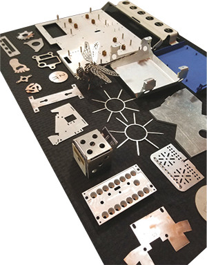

In addition, not only can Decimal perform laser blanking and slitting on material destined for stamping operations, but the company has transferred loads of work from its presses to the new laser cutter.
“We’ve been able to pull low-hanging fruit in stamping back to laser cutting due to the speed and capabilities of the fiber laser,” says Alan. “We can laser-cut parts as quickly as stamping them, without having to set up and maintain tooling, and can run unattended. We’ve moved 5000 to 10,000-part runs from stamping to laser cutting, and still perform some blanking, embossing and forming on the presses. Traditionally, stampers don’t like secondary operations. But we ask, ‘What can we take from stamping?’ We’ve cut lead times this way.”
