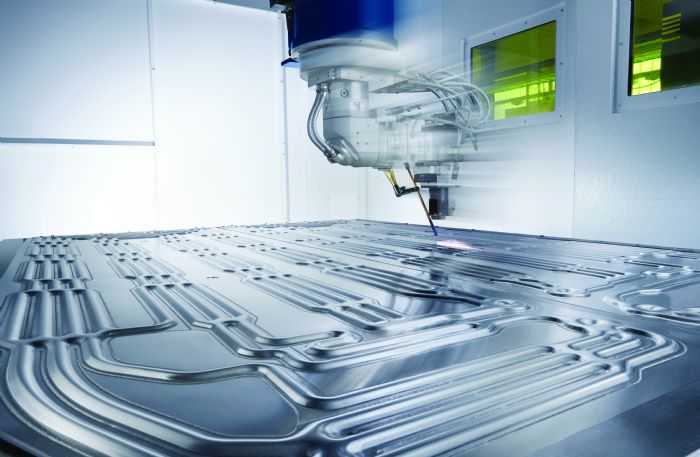

Beam shaping has produced real-world welding results. An example: the Benteler Automotive Division, which applies Trumpf’s BrightLine Weld technology and its MultiFocus optics to yield high-speed, low-spatter laser welding of aluminum cooling plates.
The Benteler R&D team developed an aluminum cooling plate, for an electric-vehicle battery pack, that requires reliable gas-tight welds. To meet this challenge, Trumpf’s industry-management team supported the effort to develop new laser-optics technology for series production, combining BrightLineWeld with its newly developed MultiFocus optics. Together, the two technologies stabilize the weld keyhole and prevent it from collapsing. The novel approach increases process efficiency, enables greater welding depths and improves weld-seam quality.
Using MultiFocus technology, Benteler recognizes an increase in the keyhole area and an enlarged melt pool, a reduction in weld spatter and improved uniformity of the weld geometry (verified by microsections), and reliable gas-tight cooling-plate welds.
Summarizing the benefits realized by Benteler:
- Spatially tailored laser-energy distribution enables keyhole stabilization and mitigation of pore formation for aluminum welding.
- Utilization of stabilized keyhole welding processes via the MultiFocus optics enables gas-tight welding for cooling plates.
- Welding speeds exceeding 10 m/min.
“The fast process speed requires a tailored input of thermal energy—this is the only way to ensure a stable capillary during welding,” explains Mauritz Möller, Trumpf’s head of global business development. “Pores can form. The MultiFocus optic prevents exactly that.” MF
