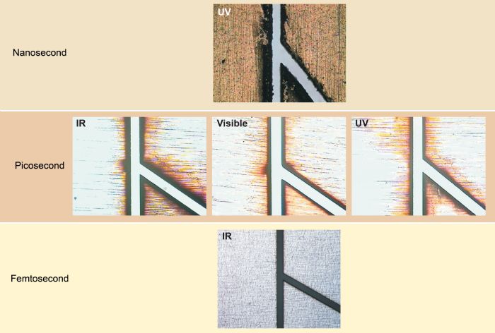

laser-cutting-Coherent-stainless-steel-IR-UV-wavelengthLonger-pulse commercial DPSS lasers commonly employ a pulsing technology called “q-switching,” which delivers pulse lengths in the nanosecond range (10 to 9 seconds or a billionth of a second). But, these lasers can be designed to produce pulse lengths in the picosecond (10 to 12 seconds) or even femtosecond (10 to 15 seconds) range.
Generally, shorter pulse lengths deliver a smaller HAZ. Furthermore, the impact of decreased pulsewidth generally is much more dramatic than that of decreased wavelength for a couple of reasons.

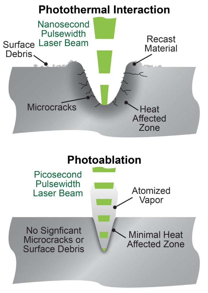

First, nanosecond pulse lengths tend to remove material by thermal meansheating the material until it boils off. But, at shorter pulse lengths (especially below 1 picosecond), another mechanism called photoablation starts to occur.
In photoablation, the use of very short pulse lengths produces very high peak fluences that can directly break the molecular or atomic bonds holding the material together, rather than simply heating it. Plus, with the material exposed to the laser energy for such a short time, the energy can’t be carried beyond the area of impact, thus the surrounding area stays cold. Energy remaining after the bond-breaking process is carried away with the expelled particles. Together, these effects result in an inherently colder process with a significantly reduced HAZ (Figs. 2 and 3). Plus, as a very clean process, photoablation leaves no recast material, thereby eliminating the need for elaborate post-processing.
But, making DPSS lasers operate at shorter pulse lengths (called ultrashort pulse, or USP) requires more system complexity, and, therefore, greater cost. Thus, cost/part versus feature necessity should be weighed. With this in mind, USP lasers generally are reserved for the most demanding tasks where precision is absolutely critical. USP lasers also enable machining of traditionally difficult materials such as glass, ceramics, sapphire and diamond.
