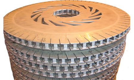

Plasma-cutting capability allows Loveman to win work fabricating convector plates used in coil annealing. The plates shown here, fabricated from carbon steel, rest between coils as coil stacks sit in an annealing furnace. Each plate consists of two face plates with ribs sandwiched between. Plasma-cutting tables cut the plates and ribs, and also cut plate holes and notches in a swirl pattern (the ribs are cut in a curved pattern to match the arc of the plate patterns). |

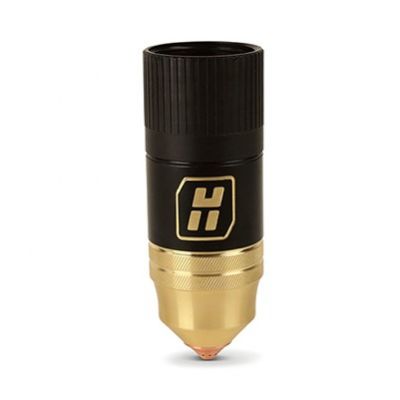

The plasma unit, using HyDefinition technology to align and focus the plasma arc, delivers numerous benefits, according to Hypertherm officials, including improved arc stability, narrow kerf width to enable fine feature cutting and minimize material waste, dross-free cutting to minimize part cleanup, and repeatable cut-edge quality.

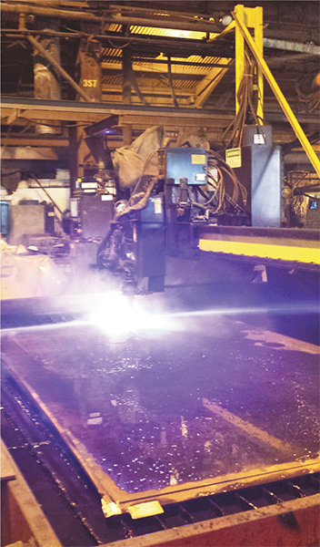

Also at Loveman, a recently retrofitted 600-A PAC water table, 156 in. wide by 552 in. long, cuts stainless and carbon steel to 2 in. thick. This table boasts a recently retrofitted Burny 10 control system from Lincoln Electric (Cleveland, OH), replacing outdated, unsupported controls. The retrofit also included a new Esab (Florence, SC) torch lifter and torch-lifter controls.

Slicing through 0.375-in.-thick carbon steel at an average of 150-200 in./min (about 90 in./min. for thicker material), the plasma-cutting tables work fast, whereas oxyfuel often limits out at about 10 in./min. In addition, Loveman works plenty with stainless steel, and oxyfuel is no option there.

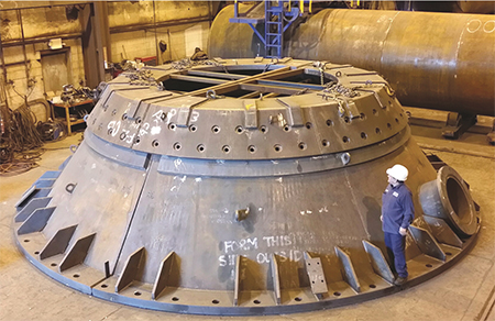

![Loveman Steel](https://www.metalformingmagazine.com/assets/issue/images/2015/09/PlasmaCutting/Plasma-3.jpg) |
Loveman Steel will receive emergency calls from mill customers at any hour to fabricate one-offs to replace broken process-equipment pieces, large and small. |
Convector plates used in the steel industry serve as one example of challenging work undertaken by Loveman made possible through the use of plasma-cutting technology.
Plasma-cutting tables cut the plates and ribs, and also cut plate holes and notches in a swirl pattern (the ribs are cut in a curved pattern to match the arc of the plate patterns). The intricate work would eat up too much time if cut via oxyfuel, so PAC gets the call.
Plasma-cutting speed is huge at Loveman, where the company will receive emergency calls from mill customers at any hour to fabricate one-offs to replace broken process-equipment pieces.
