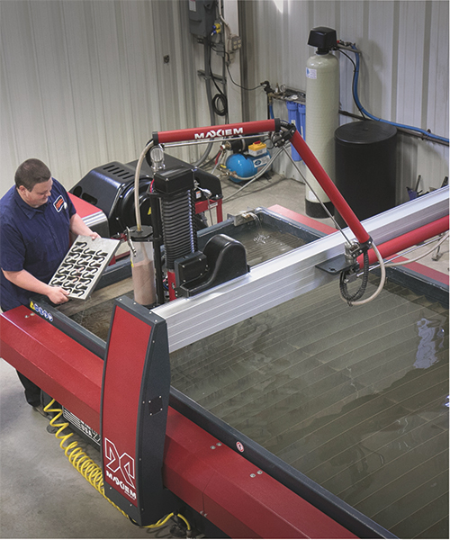

Once Perfection purchased the waterjet-cutting machine, fitting it into the company’s production environment was a somewhat simple affair, according to Gerken. Power for the new equipment posed no challenge, since the company had already upgraded that service to bring in the laser cutter. Crews simply cut a 4 by 4-ft. slab of concrete out to install a ¾-in. water line, and leveling required only a digital level, two technicians and 20 min.
After brief introductory training, Perfection unleashed operators on it to perform regular duties and test new parameters and capabilities, aided by the company’s experienced laser technician.
Installation of the new waterjet-cutting machine was somewhat simple. Crews at Perfection Fabricators simply cut out a 4 by 4-ft. slab of concrete to install a ¾-in. water line, and leveling required only a digital level, two technicians and 20 min. |

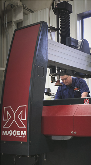

“Besides production, we employ the waterjet machine for fixtures and other items we use inhouse all of the time,” Gerken says. “If a cutting job takes 3 hr., our operator can be creative and figure out ways to increase production.”
That creativity has paid off in ways big and small. For example, to reduce cutting time, if an outside part edge is slated for welding, the machine is set to cut quickly even though doing so diminishes edge quality. Then again, for precision, say a hole must hold a 0.005-in. tolerance, the waterjet machine can do the job.

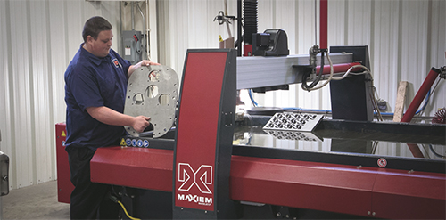

Once running, the waterjet- and laser-cutting machines formed perfect complements for Perfection.“If your goal is simply production with the right materials, a laser cutter is the way to go,” Gerken reasons. “But we have one laser, and are limited to metal alloys of a certain thickness. With the waterjet machine, we can cut any material in any thickness…we’ve already cut 2.75-in.-thick steel. But we don’t want to make that a habit due to the time it takes. We want to max out at 1.5 in. So not only does the waterjet machine complement our laser-cutting capability, it serves as our backup system. If the laser goes down, we keep working.”

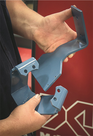

Perfection also has found ways to use the two machines in tandem. Prior to 2011, Perfection might have had to machine a certain part profile, resulting in a part cost of $125.
“Now, with our laser- and waterjet-cutting capability, we can load a program and produce that same part for $12,” explains Gerken, showing MetalForming a part that Perfection once had machined and now produces solely on the waterjet machine. “That brings customers back. Tell your customers that their parts cost more because we have to load a part, shear it, take it to a mill and machine it, the next thing you know they are down the road talking to the guy with laser- and waterjet-cutting machines.”
