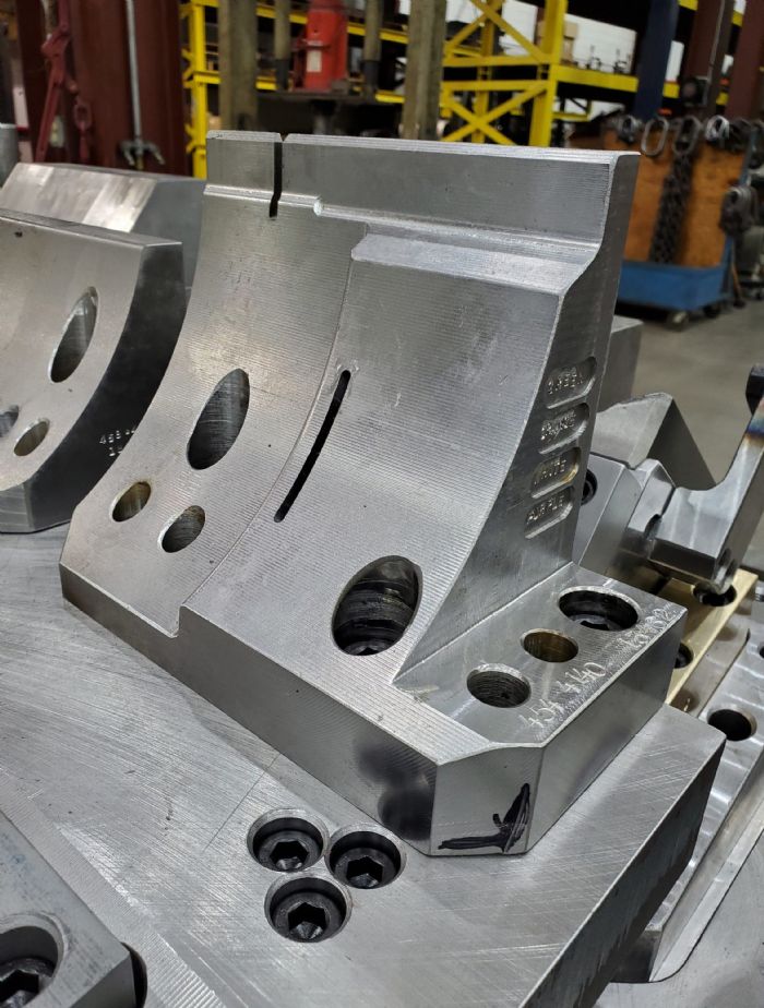

Mastercam-X-Cel-Full-Rough-BlockMachining form blocks represents a X-Cel Tooling challenge that benefits from the CAD/CAM upgrade. Consider a form block that starts out as a 4.5 by 7 by 9-in. block of D2 steel and requires a contour tolerance of ±0.0005 in. Machinists have achieved optimal cutting speeds using the Mastercam Dynamic OptiRough toolpaths with a 2-in.-high feed mill at a spindle speed of 1350 rpm at 275 in./min. OptiRest toolpaths, which enable rapid material removal with minimal tool stress, perform finishing operations.
“Dynamic OptiRest makes reworking areas with smaller radii very efficient,” says Mark Ebert, X-Cel Tooling CNC programmer, noting that the Mastercam software’s Verify function to run simulations prior to performing cuts provides quite a bonus. “It’s definitely a huge upgrade from what we had. It basically shows the exact way to handle cutting on the shop floor and eliminates a lot of the errors.”
