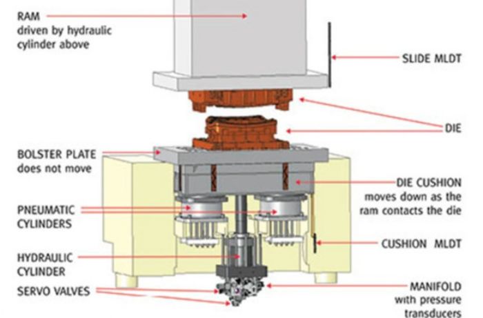

Die cushions, hydraulically operated platforms that reside under the die in the press, move to cushion and oppose the motion of the main press ram (Fig. 1). A die cushion typically pinches the periphery of a workpiece with various pad pressures to control the rate at which the workpiece is pressed into the die by the ram. The use of die cushions enables manufacture of automotive components, such as body panels, to tight tolerances and with features such as bends that prove unattainable with press-only stamping operations.

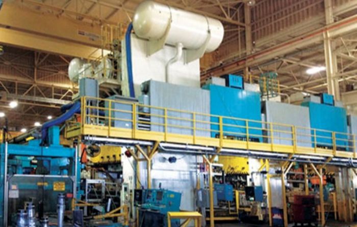

Given such requirements, Dayton Die Cushions manufactured a die cushion (Fig. 2) and retrofitted it to a stamping press at Spartanburg Steel Products, Spartanburg, SC. Not initially designed with a die cushion, the press was identified as a candidate by plant managers, who understood that to supply more of the new-generation body panels to automotive manufacturers, they would need the capabilities and precision offered by such a device.

Challenges to be met during the retrofit project at Spartanburg Steel Products included fitting the new machine components within the physical constraints of its existing press.
2-Hydraulic-Presses-Delta-Press-Cushion-CAD-Drawing“We had to take the motion of the existing ram into account to make sure that the new cushion could work with it,” says Tom Pedersen, Dayton Die Cushions manager. “The old press had a distorted bed, and we needed to align the structure before we could add our hardware. We reconstituted the bed with adjustable guides that we aligned with a 3D laser to within 0.001 in.”

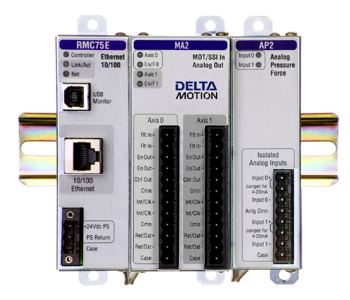

3-Hydraulic-Presses-Delta-RMC75E-motion-controllerDayton Die Cushions’ solution to this challenge: a programmable motion controller that could set up a virtual motion axis to which a physical axis could be geared. ‘Gearing’ refers to the ability of the motion of a slave axis to follow a master axis, which can be another physical axis or a virtual axis that exists only within the motion controller.

To achieve high dynamics, the team at Dayton Die Cushions selected a servo valve with high flow but very low mass. Other objectives: minimize the volume of oil flow, reduce the size of the hydraulic power unit and reduce oil conditioning, i.e., cooling, filtering, etc. Constructing this die-cushion application entirely with hydraulics would add difficulty in ensuring movement of enough hydraulic oil in the volume and time required, as the cushion measures 125 by 69 in. and must provide 250 tons of maximum holding force. As a result, Pedersen and his team incorporated two passive pneumatic cylinders beside the hydraulic cylinder (Fig. 2) to reduce the amount of hydraulic oil to be moved. The pneumatic cylinders provide the base tonnage of the cushion, and the hydraulic cylinder provides the variable tonnage that assists in shaping the workpiece.
To implement the hydraulic controls, Aleksandra Spiess, an engineer at Dayton Die Cushions, selected an RMC75 electrohydraulic motion controller (Fig. 3) from Delta Computer Systems, Inc.
“The RMC75 can run four separate task-execution engines simultaneously,” Pederson explains, noting that within Delta’s RMCTools software, each task also can run any of several user programs, one at a time. “We assigned one of the tasks to be a dedicated computation engine working in the background. A PLC wouldn’t have been fast enough to perform like the RMC.”
The motion controller connects to two servo valves, with each assigned to a separate control axis of the RMC75, which can control as many as two axes simultaneously and independently.

The new die cushion uses two Balluff magnetostrictive linear displacement transducers (LDTs) with synchronous serial-interface inputs to the Delta motion controller and Hydac high-speed pressure sensors. One LDT measures ram position and the other measures cushion position. Just prior to the ram contacting the cushion, the RMC75 opens the valves and begins moving oil through the manifold. Then, at ram contact the RMC75 runs a pressure-control loop as the cushion descends. At the bottom of the press stroke, as the ram reverses direction and ascends, the RMC is programmed to switch to position-control mode. This causes the die cushion to rise quickly, just in time to meet a robotic arm that picks the finished part out of the die.

The Dayton Die Cushions team undertook three iterations to complete the motion-control program for the Delta controller.
“As we went through the iterations, Delta’s engineers provided tremendous help,” Pedersen says. “For example, they taught us how to use the RMC75’s S-curve instruction, which initiates a smooth acceleration and deceleration to avoid hydraulic shock. They also helped to incorporate feed-forward parameters into the control loop—predictive terms that help speed response of the control algorithm.”
The team used Delta’s RMCTools Plot Manager software to prove the functionality of the system graphically and optimally tune the control-loop gains. Saving time in completing the design was important, as Spartanburg Steel Products sought to add tooling quickly in support of part production for the new automotive model year.
