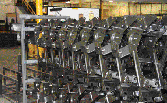

These automotive parts make their through a coating process at Michigan-based Spectrum Industries. |
Near the end of 2007, SKD-Jonesville brought in Spectrum Industries, with locations in Grand Rapids and Belding, MI, to e-coat oil pans.
“Spectrum paints what may be the most difficult part that we send out for this type of work,” says Steve Orey, SKD plant manager. “This is the fourth painter we’ve contracted with in the two-and-a-half years since we launched this program, and none of the other painters could provide the level of quality required, leading to extensive repair, rework and inspection. Spectrum took the part through new-product-launch containment (to prevent shipment of poorly painted parts back to SKD), and instituted a second level of containment. In that second level Spectrum has not found any defects. Any issues are dealt with on the paint line at Spectrum, before parts ever reach us.”
The oil pan must be tilted correctly on racks during the coating process. Not enough tilt yields paint beads on the bottom of the pan. Too much tilt can create air pockets, another no-no. Also, the part is a metal-plastic-metal sandwich, creating further challenges as it must be electrically charged to get paint to adhere to the surface.
“Spectrum created low-cost racks that from the outset properly oriented parts,” Orey says. “The pans coming off of that line look better than any pans I have ever seen.”

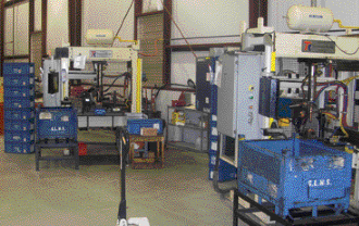

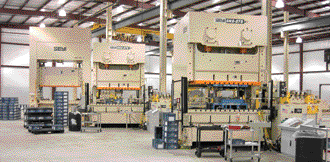

Processes at Great Lakes’ Bridgman plant include precision stamping, custom welding, assembly, and tooling maintenance and repair. The 38,000-sq.-ft. Alabama facility, which began operations in May 2007, brings those same services to Southern customers via a roster of 23 employees. Equipment includes two 275-ton mechanical coil-fed presses and one 300-ton press, all from Seyi America, Inc., Walnut, CA, backed by automated resistance-welding machines and a CMM-supported quality lab. Plans call for robotic gas-metal-arc welding, vibratory deburring and parts straightening, according to Keith Hettig, Great Lakes president.
To ramp up quickly in Alabama and maintain supply-chain continuity, Great Lakes specified a CMM and software as well as press models and coil-feed lines that duplicated those in Bridgman.

These resistance-welding cells comprise part of the value-added lineup at Great Lakes Metal Stamping’s new Alabama plant. |
