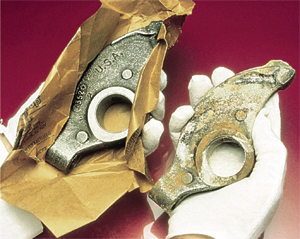

VCI protection can function on high and low volumes of parts large and small. Take electrical connectors for example.

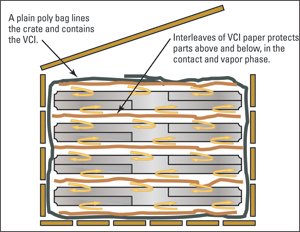

Fineblanked parts yield a more traditional mid-volume application, according to Simpson. “Consider the stamper that stacks several hundred fineblanked parts—about as large as your hand—into a bulk crate,” he says, “lined with a VCI bag. The bag, constructed of low-density polyethylene, is impregnated with VCIs that protect those parts that contact the bag as well as parts in proximity to the bag. Interleaves or paper or film VCI sheets may be added depending on the size of the crate, laid at intervals as the parts are stacked to ensure delivery of enough VCI to protect parts in the center of the crate. Just close the bag and crate for shipment. So, VCI packaging is not terribly different from what is done with conventional packaging materials.”
