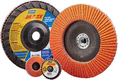

Stainless steel, intrinsically stronger than carbon steel, generally is of much thinner gauge. This feature has implications for grinding, which will be discussed later. The weld finish for stainless steel also depends on the application. For instance, a highly refined finish may be used for aesthetic purposes, whereas an elevator wall panel or hand rail requires a functional No.4 finish to disguise the visibility of fingerprints and scratches.
| Flap discs typically get the nod for stainless steel finishing. |
