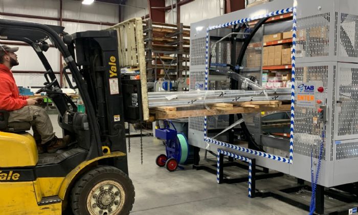

Releasing a bottleneck in the packaging department that threatened the
company's stellar lead times, the TAB Wrapper Tornado automatically wraps
stretch wrap 360 deg. around and under the pallet and load while it is raised
on a forklift, creating a secure, unitized load without banding or boxes. The
orbital wrapper safely encases the full length of the fabricator's custom 10-
and 16-ft.-long pallets required for many of the elongated metal parts it
fabricates.
Speeding production while reducing the number of workers involved in the wrapping process down from two or three to just one worker, the orbital wrapper saves an average of 2.5 hr./day, or more than 78 full, 8-hr. workday/yr., according to Mike Roeder, president of Penn Sheet Metal.
“We were wasting so much time wrapping pallets by hand until I'd finally had enough,” says Roeder. “Now we're getting a much better, more secure wrap every time, even on our longest skids and it wouldn't even be possible to wrap them by hand—I just love this machine!”
