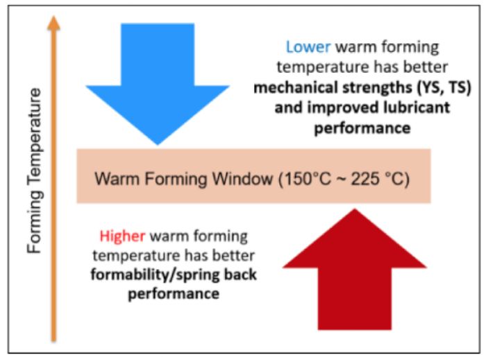

Complex body parts and advanced high-strength aluminum alloys such as those in the 7xxx series can prove difficult to form in traditional cold-forming operations. Here, stampers can opt for warm or hot forming: Heating aluminum blanks prior to forming can increase the material’s ductility by 20 to 80 percent.
During warm forming, blanks are heated to 150 to 250 C; automotive suppliers are evaluating the process for use on aluminum closures such as inner doors, and some thinner-gauge structural parts. Stamping heavier-gauge advanced high-strength aluminum alloys, such as Type 7075, typically requires hot forming—heating blanks to even higher temperatures, 450 to 490 C. At these higher temperatures, lubricants become more susceptible to melting, which depletes performance, and to carbonization of the residue, which can make cleaning difficult.

Lubricants for Warm Forming
Warm forming, while a less-established process to stamp aluminum, has the attention of many OEMs and industry consortiums that are investigating its feasibility. Several studies, such as one completed in 2017 by EWI, titled, Practical Warm and Cold Forming Technologies of Aluminum Alloys for Lightweighting Structures, have demonstrated that heating blanks to 225 C will improve the formability of 6xxx- and 7xxx-series aluminum alloys. Compared to the higher temperatures used in hot forming, the lower temperatures used in warm forming can provide significant benefits. Among them:
  • The lower temperatures do not generally deplete the strength of the aluminum.
  • Warm forming does not require an accelerated aging process beyond paint-bake temperatures in order for the aluminum to regain strength, avoiding the need for a post-forming tempering process.
  • The lower temperatures require less energy and fuel, minimizing process costs.
  • Lubricant formulators have more ingredients at their disposal that can perform well without melting or carbonizing, including the recent development of a water-based emulsion composed of inorganic salts and synthetic lubricity additives. This lubricant has been used in warm-forming tests consisting of anisotropic pan draws of 6xxx-series aluminum alloys, stamping of rails from Type 7075 aluminum, and cup draws. The lubricant promotes lubricity, does not carbonize on parts and can be readily cleaned. Best results occur when the lubricant is applied to panels and allowed to dry prior to stamping. The drying can occur in the blank-heating oven and, when dried in the oven the lubricant will exhibit increased emissivity and even quicken the heating process. MF
