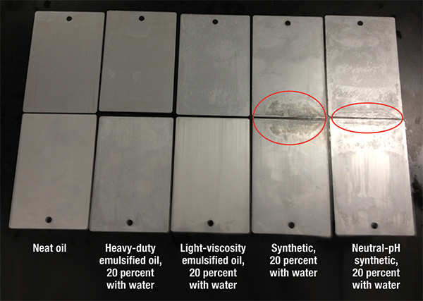

Neat Oils and Oil-Based Emulsions for Coated Steels
Zinc-coated steels require a fresh approach to stamping lubrication. Zinc protects steel in two s: it acts as a physical barrier to oxygen and moisture and as a sacrificial anode to the iron. For stamping these steels, neat oils provide the best anti-corrosion properties because the oil residue is impervious to moisture, and oils create low conductivity.
The next-best alternative: oil-based emulsions, which can be made water-soluble with additives and emulsifiers. Emulsifiers are polar, with an affinity for water and oil. In effect, microscopic droplets of oil are dispersed and stabilized in water. As a residue on parts, water evaporates and leaves an oily film that protects against oxidation. For use with multi-metal substrates, it is important that the lubricant not contain high levels of alkaline additives.

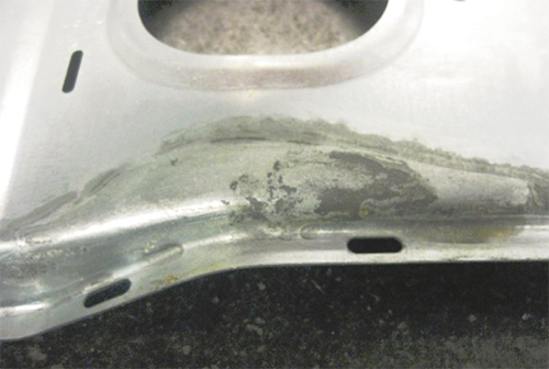

Synthetic lubricants form solutions in which the additives are dissolved in water. As a residue, most do not create a vapor phase to protect the substrate. Typically these products rely on amine salts for corrosion protection of ferrous alloys. The alkalinity of these salts creates conductivity that can promote galvanic reaction, which accelerates the oxidation of the zinc to form zinc oxide, or white rust. If the residue is tenacious, such as with many synthetics designed for HSS, the oxidizing effect can be exacerbated from the presence of higher film coatings. Where parts are in contact, the presence of water and alkaline salts creates a galvanic reaction in which severe corrosion can occur.
In galvanealled steel, iron is present in the zinc substrate. This alloy-like substrate makes this steel even more susceptible to galvanic reaction. Eventually, zinc oxide can react with the soap complexes in synthetics to form an insoluble zinc stearate that bonds with the substrate. In this condition, it is difficult to physically remove the corrosion with Scotch Brite pads. If removed, pitting or staining to the base metal remains.

Historically, North American stampers use water-miscible lubricants. Here, costs can be substantially reduced by diluting these products with water. Whether the oil is derived from petroleum or plants, many of these emulsions provide substantial anti-corrosion protection. This characteristic can be increased by stacking parts in a manner that avoids lubricant puddling, or tight nestling.
Better yet, work to optimize application to avoid excessive residue. This strategy proves most important when working with synthetic lubricants. Stampers must avoid saturating parts when using these water-based products. Galvanealled steel is most prone to corrosion in this condition, but even galvanized and bare steel can corrode when overly wetted with synthetics.
Some synthetic lubricants have reduced alkalinity, and may be designed with poor wetting characteristics so that lubricant beads off the part. These conditions reduce the exposure to conductive films and improve compatibility with zinc-coated steel. However, alkalinity in synthetic lubricants provides the primary anti-corrosion properties on ferrous metal. Also, poor wetting characteristics may require excessive reapplication or may lack the film presence required for severe stampings.
A select few synthetic lubricants provide synthetic vapor barriers or may provide controlled passivation of zinc. These products reduce the risk of corrosion, but none outperform neat oils or even some emulsions. MF
