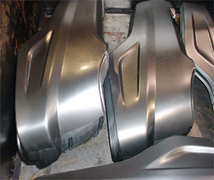

Deep-drawn mower side panels formed through a four-press cycle using multiple tools, ready to be washed and painted. |
