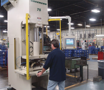

Ilsco’s 75-ton hydraulic press features an integral knockout cylinder mounted in the main ram for punching, trimming and marking electrical connectors in aluminum up to ½ in. thick, and for forming copper. |

Ilsco’s hydraulic press of choice: a 75-ton model (from Greenerd Press & Machine Co., Nashua, NH) with an integral knockout cylinder mounted in the main ram for punching, trimming and marking electrical connectors in aluminum up to ½ in. thick, and for forming in copper. The press includes a heavy, welded frame that optimizes rigidity and minimizes deflection, to ensure dimensional accuracy and repeatability, and provide long tool life. A large daylight and throat depth accommodates large dies, and long stroke lengths are adjustable from 1 to 18 in.

“With the addition of the Greenerd press,” says Tipton, “we significantly increased productivity in several s. Its adjustable stroke length and tonnage capabilities provide us with tremendous versatility. Due to the large 18-in. stroke capacity, we’ve been able to standardize our dies and replace three mechanical presses–30-, 25- and 60-ton models–with the one hydraulic press.”
