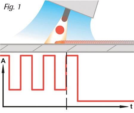

1) Pulse/short arc (Fig. 1), which provides maximum control over heat input for welding sections as thin as 0.24 in.*, as well as for root-pass welding.
*Minimum and maximum thickness possibilities depend on wire diameter and type.

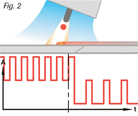

2) Pulse/pulse (Fig. 2), for welding material 1⁄16 in. and thicker* with great control over heat input, bead profile, bead appearance and travel speed.

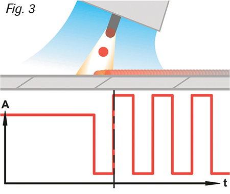

3) Spray arc/pulse (Fig. 3), for higher productivity on thicker sections while still preserving the ability to weld vertical-up without any weaving motion, which reduces operator fatigue.

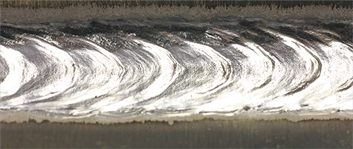

Conversely, the modified pulsed-spray transfer process inherently creates the desired stacked-dime bead appearance, as weldmetal deposition rates consistently vary when the system switches between transfer modes. The process eliminates the variables associated with gun manipulation, promoting uniform penetration throughout the length of the weld and minimizing issues related to stress risers. Further, the process enables fabricators to obtain premium bead appearance with fixed and flexible automation systems—particularly handy for circumferential welds on pontoons or for long seam welds on trailers.

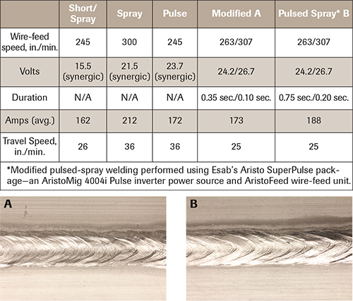

These images show the weld beads associated with the parameters for the modified pulsed-spray processes (A-B) in the table. They demonstrate that fabricators can reduce filler-metal costs by using a larger-diameter weld wire on thinner materials.

To demonstrate the flexibility of the modified pulsed-spray welding process, tests were conducted using 0.062-in.-dia. type 5356 filler wire. Welders deposited fillet welds using test coupons of 1⁄8-in.-thick type 6061 aluminum.
The results for the short arc/spray process (second column) can be discounted, as the process lacks sufficient energy for welding with 0.062-in. wire. The welds looked cold and lumpy.
To obtain a conventional spray-arc transfer, the wire-feed speed was increased to 300 in./min. However, obtaining a weld size similar to the pulse-mode sample—and to not melt through the workpiece material—required a travel speed of approximately 72 in./min., nearly impossible for a welder in a production environment. If the welder were to slow down to a manageable travel speed of 36 in./min., the risk of burnthrough becomes high, plus the workpiece material becomes overheated, the weld becomes hard to control and bead appearance is poor.
Conversely, the pulsed- and modified pulsed-spray transfer processes have no problem. Travel speeds remain manageable and heat input is controlled to prevent burnthrough.
