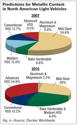

The trend a from HSLA steels to AHSS (Fig. 4) is noteworthy. Use of AHSS in North American light vehicles is expected to grow from 9.5 percent in 2007 to an estimated 34.8 percent in 2015.

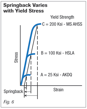

Springback als is present when forming lower-strength steels, and requires die compensation to meet part prints. The amount of springback relates directly to yield strength. So it follows that AHSS, particularly CP and MS grades, prove especially difficult to control because of the large amounts of springback (Fig. 6). While common low-strength AKDQ steel typically exhibits springback of 2 to 3 percent, and springback of an HSLA steel typically is 8 to 12 percent, an MS steel exhibits springback of 16 to 24 percent.
Springback, sidewall curl, and panel twist all have their origins in unbalanced stresses in the formed part. These stresses often result from the product design—nonsymmetrical geometries or cutouts, rapid changes in cross section or unequal flange lengths. Other causes include inconsistent forming-process parameters, including lubrication, polishing, blankholder forces, blank positioning and broken or worn draw beads.

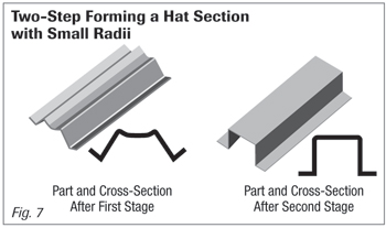

Automotive design engineers often specify the use of channel or hat-style sections in structural product designs. Unfortunately, the 90-deg. angles, parallel walls and the need to bend the sidewalls over a radius all contribute to the potential for increased springback. To achieve a desired channel height while limiting movement across radii, form hat sections using a two-step approach—the gull-wing process (Fig. 7). First, form all 90-deg. radii and mating surfaces with the required overbending for springback compensation. Flattening the large radius in top of the hat section occurs in the second operation, which may require additional overbending of the flat, top section to produce parallel walls.

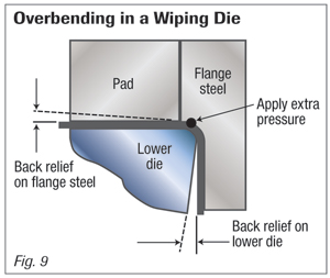

Stampers should incorporate overbending into the wiping die to compensate for springback. Anticipate as much as 10 deg. of springback, depending on the grade.
Fig. 9 illustrates a springback-compensation technique found in the High Strength Steel Stamping Design Manual, published by the Auto/Steel Partnership. The flange steel has a radius less than the part radius, coupled with back relief on the flange steel and forming post. Back relief on the flange steel allows application of additional pressure further out on the formed radius.
To coin AHSS and reduce the material thickness through the radius, the die must exert very high pressures in the flange-steel corner radius. Significant concerns under these conditions include flange-steel wear, strength and reliability.
