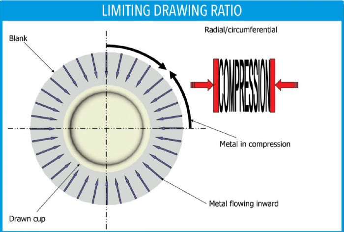

Beginning with the process necessary to draw a round cup, the basic idea is to pull the circular blank into the cup-shaped cavity using a punch that is the reverse of the inside shape of the desired cup. The blank must be larger in diameter than the cup’s finished diameter. For the blank’s diameter to be reduced, it must be pulled into the cavity simultaneously. Squeezing the sheet is called compression. If compression occurs all the way around an axial symmetrical part such as a cup, that is “circumferential compression.” Remember that when sheet metal is forced into compression, that creates a resistance to flow. It is the compression that’s creating the resistance (Fig. 1).

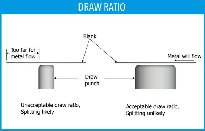

Draw Ratio Fig 2If there is excess resistance, the metal ultimately will stretch and potentially could rupture. For this reason, carefully limit the amount of surface area in compression by maintaining a direct relationship between the diameter of the forming punch and the diameter of the blank. This critical relationship is referred to as the limiting drawing ratio (LDR). In other words, if the drawing punch is large enough or close enough to the blank edge, this will limit the amount of compression and the metal likely will flow inward. If the blank is too large in relationship with the drawing-punch diameter, the resulting excess compression will generate great resistance to flow and most likely result in excessive thinning, and potential splitting (Fig. 2).

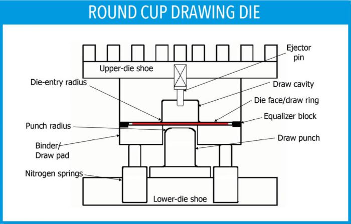

Round Cup Drawing DieIt also is important to understand that compression not only creates a resistance to flow but it can result in wrinkles and even double-thickness problems. This is why a high-pressure drawing pad, often referred to as the binder or blankholder, is necessary. A drawing pad prevents the sheet metal from wrinkling by restricting the gap in the blank area that is in compression to only slightly thicker than the sheet thickness. In short, the spacing between the two surfaces won’t allow the material to wrinkle. That spacing is maintained by using a series of special blocks mounted outside of the blank, called equalizers or standoffs. If the compression is extreme, the sheet actually can get thicker than its original thickness (Fig. 3).
