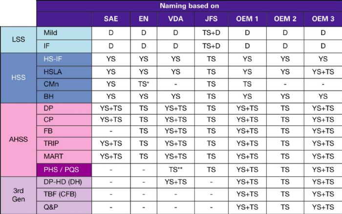

Table 1 shows the naming systems for various grades used by automotive OEMs and standards-writing bodies.  For example, the generic DP590 steel may be named:
  • SAE J2745 DP590T/340Y (where T signifies tensile strength and Y yield strength);
  • EN 10338 HCT590X (H signifies high strength, C cold rolled, T tensile strength, X dual phase;
  • VDA239-100 CR330Y590T-DP (cold rolled 330-MPa minimum yield, 590-MPa minimum tensile strength, dual phase; or
  • JFS A2001 JSC590R (cold rolled, 590-MPa minimum tensile strength, and R signifies dual phase).

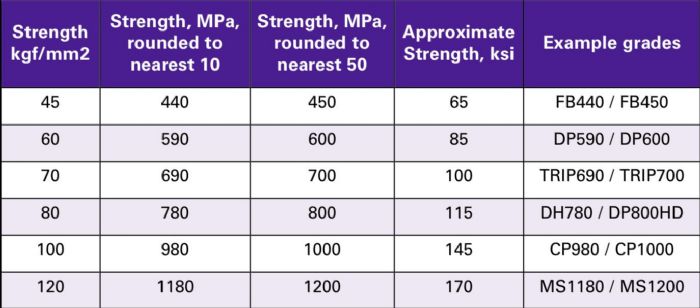

590 or 600? 780 or 800? Why?
Table 5Some people refer to DP590 steels as DP600, and some refer to DP780 as DP800. This rounding occurs because the earlier SAE norm (J2340-1999) referred to strength levels of 600, 800 and 1000 MPa. Now, most steel standards list strength levels as 590, 780, 980 and 1180 MPa. One may argue that DP590 and DP600 are not the same, claiming theoretically that a coil with 595-MPa tensile strength would qualify to be named DP590 but not DP600. Even though some OEMs still use 600, 800 and 1000 in their steel names, on the spec sheet their minimum tensile-strength requirements still are 590, 780 and 980 MPa.
So, in practice it still is correct to use 590, 690, 780, 980 and 1180. They seem arbitrarily chosen, but when divided into the gravity constant (9.81 N/kg) the logic behind these numbers emerges (Table 2). In some parts of Asia, steels are referred to using a number based on kgf/mm2. For example, a TRIP 980 steel may be called 100K TRIP. This is especially confusing for Americans, as it may be understood as 100-ksi TRIP steel, equivalent to TRIP 690.

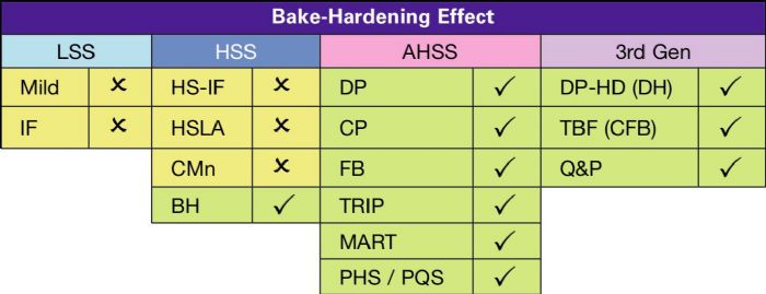

Bake Hardening and TRIP Effects
Bake-hardening (BH) steels is a baffling name, as most people in the industry and academia believe that only BH steels harden during paint baking after deformation. BH steels (Table 4) are the only grades in the HSS family to exhibit the bake-hardening effect. All AHSS, including Gen 3 steels, have even higher (between 40 and 100 MPa) bake-hardening indexes, compared to BH steels (typically 25 to 40 MPa).

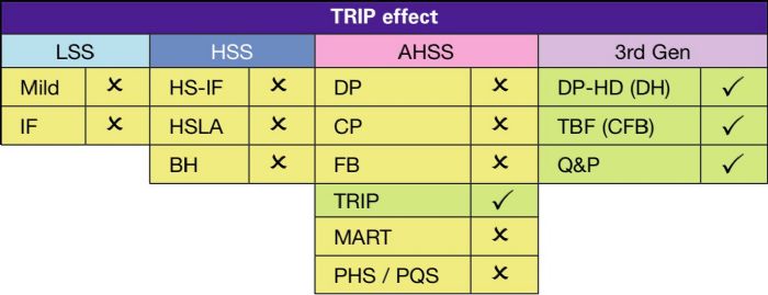

Within the 1st Gen AHSS, retained austenite is only found in TRIP steels. When austenite is deformed, it may transform to martensite. This increases the strain-hardening rate, and thus improves formability. This is called TRIP effect. In 2nd Gen AHSS, austenitic stainless steel can be nearly entirely austenitic. 3rd Gen AHSS also rely on the TRIP effect for improved formability. So far, all commercially available 3rd Gen AHSS have retained austenite and thus the TRIP effect, as shown in Table 5. MF
