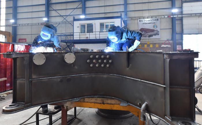

AHSS offered by SSAB includes the Strenx line, with a Turkish concrete-pump company, Betonstar, using Strenx 900 (MPa) structural steel (pictured, during pump fabrication) to produce lighter-weight pumps used on customers’ vehicles.
“Pumps that reach over 50 meters are in a special class,” says Selim Alver, R&D manager at Betonstar. “To manufacture those, we require special engineering and materials, and that is why we need Strenx steel.”
Thanks to the high-strength steel, Alver reports, Betonstar has been able to use a special, lighter design for the longer booms, which adds customer value.
“We have great design flexibility thanks to Strenx,” he says. “For our latest 52-meter pump model, we could switch from five foldable booms to six foldable booms. It led to a lighter pump, and we decreased the weight from 41 to 39 tons. This is very important for the end user because we were able to mount the pump on a 12-meter vehicle that does not require a special permit to travel on the roads.”
