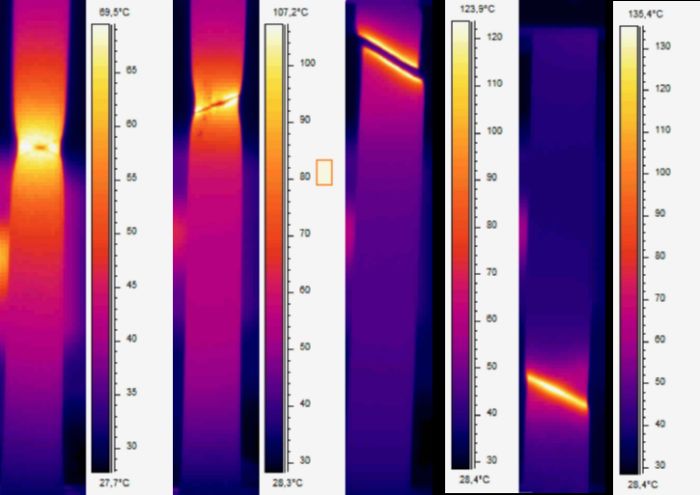

Fig. 1 illustrates tensile-test results, recorded with a thermal camera, for two different steel grades—DC04 (a mild steel similar to a deep drawing grade), and HCT980X (similar to DP 1000). The high-speed thermal camera captured the temperature increase in the fracture zone.
When pulling the mild steel at 50 mm/sec., the temperature at the fracture zone peaks at 69.5 C. When quadrupling the test speed, heat cannot dissipate as quickly as during the first condition. Also, due to strain-rate effects, about 5 percent more work is performed, and the temperature rises to 107.2 C. Note: After only 0.5 sec., the maximum temperature drops to 94.0 C. The heating and cooling cycle occurs in very short time intervals and is localized in a very confined area of deformation.
When we pull the higher-strength HCT980X alloy, the peak temperatures are 123.9 C and 135.4 C, respectively.

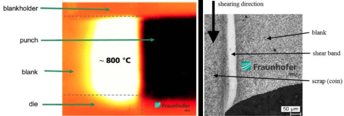

During blanking, the plastic deformation—and so the heating—is very localized to just the periphery of the punch (Fig. 2a).
