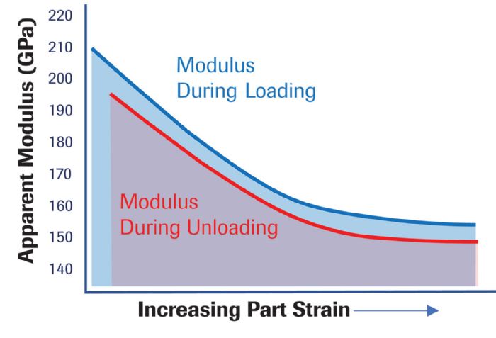

Figure 2-Modulus DecreaseForming-simulation analysts incorrectly treat the elastic modulus as a constant. While the standard 210-GPa and 70-GPa values serve as reasonable approximations for generic steel and aluminum alloys, the modulus can vary by as much as 10 percent for some grades, depending on the orientation relative to rolling direction. Complicating matters: The magnitude of variation as a function of orientation relative to the rolling direction is not constant between all grades.
The bending-unbending sequence as sheet metal passes over draw beads, die radii and draw walls leads to what is known as the Bauschinger effect. Among other implications, the Bauschinger effect reduces the elastic modulus each time the sheet undergoes the tension-compression associated with each bend-unbend. In addition, increasing strains from material flow occurring as the part reaches the designed shape further lower the elastic modulus.
In a tensile test, a comparison of the modulus measured during loading versus when it is measured during unloading reflects these differences. One study on a dual-phase steel with a tensile strength of 780 MPa showed that areas with 11-percent strain experienced a 28-percent decrease in the elastic modulus (Fig. 2). Accurate springback simulation requires capturing this variation in elastic modulus. MF
