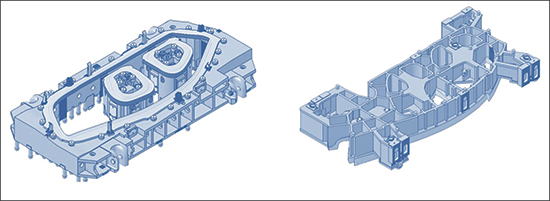

 when stamping high-strength steels, the blankholder is larger in size and more solid in its design
Fig. 1—When stamping high-strength steels, the blankholder is larger in size and more solid in its design, which requires pressurization of additional gas springs, and may even require a slower velocity on the return stroke. Shown here are the blankholder station (drawing) and pad station (trim and form) for a bodyside outer.
When forming special materials such as aluminum or HSS, several factors in the die influence the optimum forming speed. These include speed requirements of the blankholder as it opens or closes; special forming operations from cams within the die; and vibrations due to breakthrough as the material cuts. Programming the servo drive to accommodate these factors can greatly improve quality, die-component life and process stability while also delivering improved throughput.
Blankholders’ Impact on Slide Speed
When trimming materials such as aluminum or HSS, a blankholder inside the die fixes the part in place before the slide moves the die to begin the trimming operation. In the case of HSS, the blankholder must hold the part in place to ensure the blank does not move during the high-tonnage cutting operation. The stamper must take great care to control the process and ensure there is no excess energy emitted and that the process remains stable. Note: a similar reduction in speed is required when the slide touches the blankholder for drawing processes, as well.
Just before the slide engages the die, the blankholder accelerates to hold the part in position using gas springs (or pins). The blankholder engages and does not move while the slide moves down and then up to perform the trimming operation. When the slide returns, the springs or pins also must achieve a certain speed per tonnage to match the speed of the slide, to reduce vibration in the die and not overload cams or other in-die components. This is the velocity limit on the return stroke related to the blankholder. When stamping high-strength steels, the blankholder is larger in size and more solid in its design, which requires pressurization of additional gas springs or pins (Fig. 1), and may even require a slower velocity on the return stroke.
