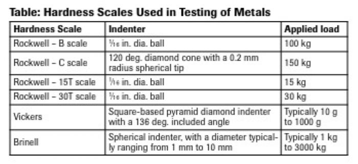

Hardness testingSimply, hardness represents a material’s resistance to indentation. Of course, this resistance varies among material types, but hardness-test results also depend on the size, shape and material of the indenter, and the amount of force used to push it into the sheet metal. The appropriate scale is a function of these testing parameters. The accompanying table displays the testing conditions associated with common hardness scales used in metal testing.
Determining Rockwell hardness values requires a two-step process. First, the test apparatus pushes the indenter (either ball- or cone-shaped) into the test-piece surface until reaching the desired preload (also called “minor load”) force—10 kg for the B and C scales, and 3 kg for the N and T superficial scales. This small initial penetration seats the indenter and provides a reference depth. Application of an additional “major load” results in deeper penetration into the sheet metal surface. Removal of the major load occurs, followed by a re-application of the minor load. The Rockwell hardness calculation defines the difference between this depth reading and the reference depth as “d” in the equation for the Rockwell B scale:

Regardless of which type of hardness scale is used, making a deeper, wider impression allows for more accurate and representative readings. However, if the impression is too deep, then the hardness of the platform that supports the test piece, known as the anvil, will influence the result. According to ASTM Standard E18, Standard Test Methods for Rockwell Hardness of Metallic Materials, to avoid this so-called “anvil effect,” indentation depth must not exceed 10 percent of the total test-piece thickness. Using an inappropriate hardness scale with an excessive indenter force results in a shiny spot on the test-piece underside showing where the indenter pushed into the anvil surface (figure above). Creating such a spot indicates that the test has measured the hardness of the anvil, not the test piece, and that the test conditions will need to be changed in order to produce a smaller, shallower indentation. In cases where the test pieces are too thin for Rockwell B and C scales, technicians will use the Rockwell superficial scales of T and N, as these scales use reduced minor and major loads compared to those used for B- and C-scale tests.
Hardness Scales used in Testing of MetalsAn example of where this matters:  Using the measurements described earlier in this article, a test providing a Rockwell B hardness reading of 80 or less on sheet metal less than 1 mm thick violates the ASTM requirements. Why? HRB80 indicates a 0.10-mm indentation depth―with lower hardness readings associated with increasing indentation depth. Ten-times this indentation depth is 1 mm, and any greater penetration violates the 10x rule; you’ll likely see the influence of the anvil in the test results. The applied load on the Rockwell B scale is 100 kg. Should a shiny spot appear on the underside of the test samples, switch scales to produce a shallower impression, potentially to the 30T scale, with a 30-kg applied load.
