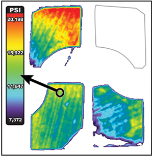

Pressure image
This pressure image of the progressive die reveals that three of the four bumper blocks experienced pressure of 7000 to 20,000 psi, while one block failed to make contact, requiring a shut-height correction.

Five Star Tooling applied Pressurex to a 5-ft.-long progressive die used to stamp a structural automotive part. It applied the film between mating cutting and forming components as well as to bumper blocks, revealing local pressures that can be modified to optimize die balancing.
“Accurately balancing the die by obtaining pressure readings from the various operations results in higher quality dies and lower die-maintenance costs,” says Graenert. “The restrike station, for example, often exerts a concentrated force near the exit side of the die. Unbalanced pressures can cause the die to ‘kick,’ causing premature fatigue, excess wear and subsequent cracking or breakage of die components. This can be minimized by using the pressure readings from the film and varying stripper pressures to balance the tool.”
