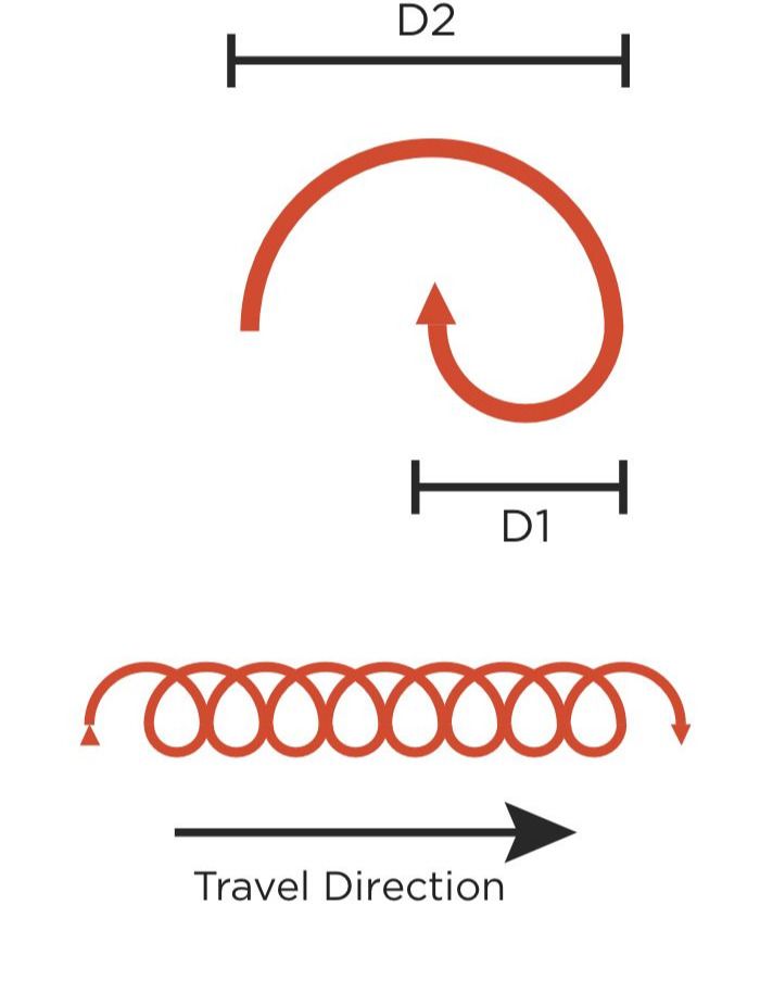

Fig. 2Laser stirring has been adapted from electromagnetic arc stirring, a technique that combines the electromagnetic stirring of arc welds with electron-beam oscillation. This process has been shown to break up the dendritic microstructure of aluminum alloys, encourage an equiaxed grain structure, reduce thermal gradients at the edge of the melt pool and decrease mean grain size. Each of these attributes proves beneficial in reducing solidification cracking in high-strength aluminum alloys and austenitic stainless steels.
During LPBF, laser stirring replaces linear hatches with repeated circular or elliptical scan paths (Fig. 1). EWI’s laser-stirring process aims to:

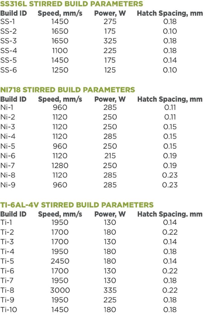

Process Parameters for Trials

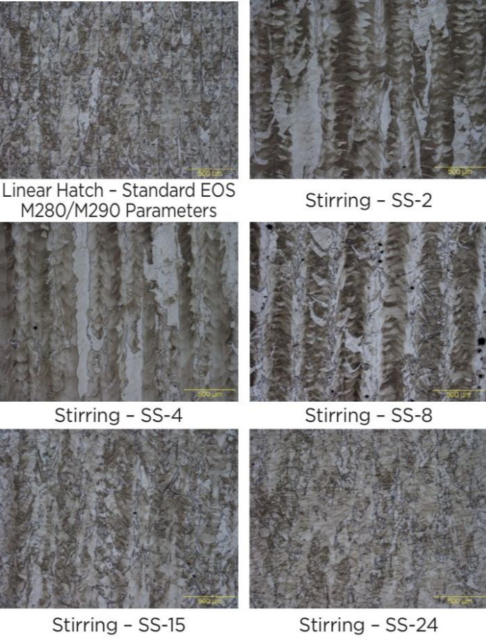

We employed a circular stirring pattern along with the laser parameters for the coupon trials (Fig. 3), which show, for Type 316L stainless steel, the typical as-built microstructure for linear hatching and variations in microstructure possible with stirred hatching. The stirred hatching builds to display larger grains, columnar grains, less-elongated grains and/or combinations of large and small grains, depending on the stirring parameters employed.

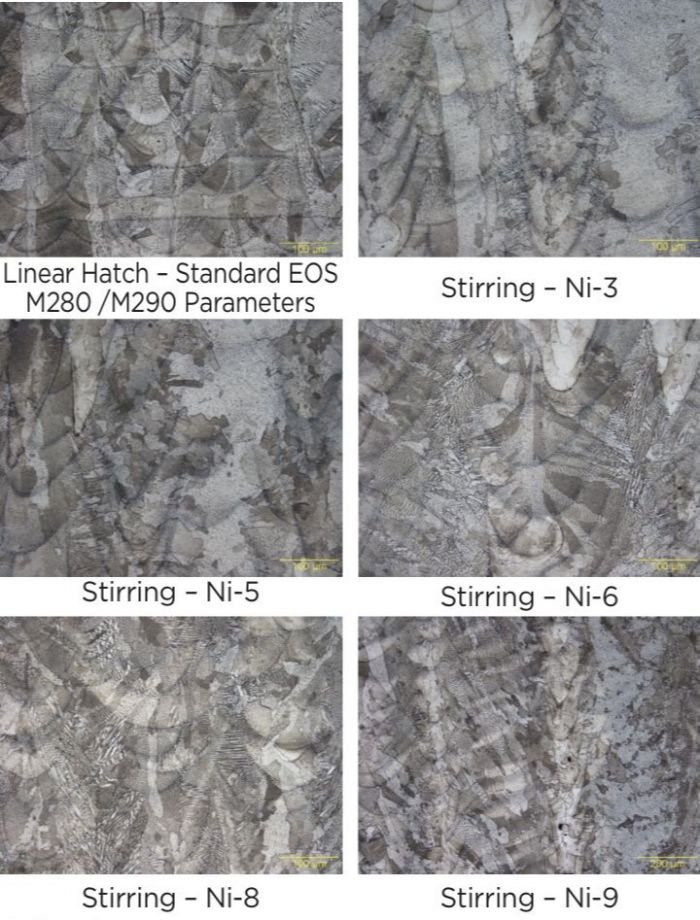

Fig. 4 shows the typical as-built microstructure for linear hatching and variations in microstructure possible with stirred hatching for Inconel 718. Grain refinement and the formation of necklace microstructure, containing both large and small grains, are apparent in the stirred hatching builds.

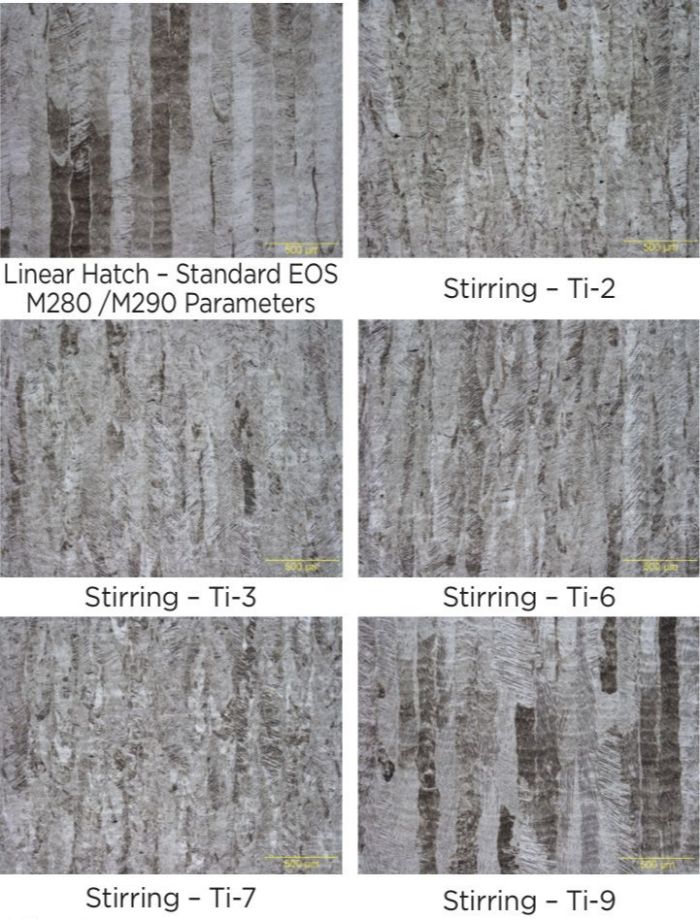

Fig. 5 shows the typical as-built microstructure for linear hatching and variations in microstructure possible with stirred hatching for Ti-6Al-4V.
