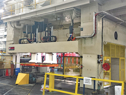

The GAS group has upgraded two large transfer presses with new PLC-based open-architecture controls, including this 1600-ton Verson transfer press at the GAS plant in Monterrey, Mexico. “The open-architecture controls,” explains process engineer Mark Turk, “optimize flexibility, ease and quicken installation, and provide the features needed for timely and accurate troubleshooting.”
The beauty of open-architecture PLC (programmable logic controller)-based press controls is not lost on Mark Turk, a process engineer with Tier One automotive supplier Dura Automotive Systems. Dura and its sister company Global Automotive Systems (GAS) group operates seven North American plants, including metalforming and assembly facilities in Monterrey, Mexico, and Milan, MI. Both of these facilities have welcomed, in recent years, transfer-press upgrades centered on press-control. And, both retrofit projects feature PLC-based setups configured with off-the-shelf Allen-Bradley processors and I/O modules; software for signature analysis; web-based fault-history reporting; and more.
Specifically, Turk oversaw control upgrades to a 1600-ton Blow transfer press (96 by 268-in. bed at the GAS Milan facility (in late 2007), and to a 1600-ton Verson transfer press at the GAS plant in Monterrey (in 2015). Both control retrofit projects, explains Turk, feature HelmPak press controls from Helm Instrument Co., Maumee, OH, “designed,” he says, “to optimize flexibility, ease and quicken installation, and to provide the features needed for timely and accurate troubleshooting.”

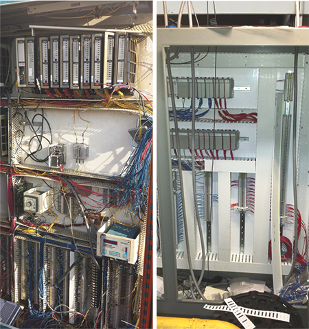

These photos compare the wiring complexity of the old control cabinet (left) installed on the Verson press in Monterrey, and the new press control, which features off-the-shelf Allen-Bradley processors and I/O modules.
“And, with the PLC-based control architecture,” Turk adds, “we use Ethernet connectivity for all of the components in the press line. This reduces the amount of wiring in the setups, while also making the line-changeover process quick and efficient, reducing setup times. The controls include enough memory to store process parameters for 999 jobs, including settings for pilot release, coil-feed and transfer-system functionality, and counterbalance control—automatically moving the slide to the proper shut height, and then adjusting the counterbalance to the proper upper die weight.”

Ease of installation, with minimal press downtime and production interruption, played an important role in the Monterrey press upgrade. That press, says Turk, includes an eddy-current flywheel drive and magnetic clutch-brake system. “Integrating that drive with the new control was a challenge, but the PLC-based setup, with its flexibility and efficient wiring design, helped streamline the installation process.”

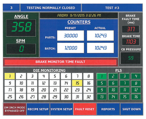

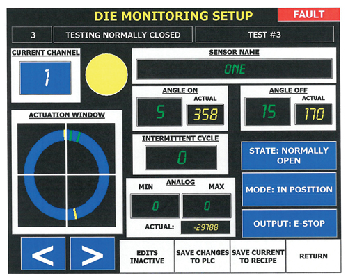

With the PLC-based control, human-machine interface (HMI) screens are completely customizable. Shown are the main screen (left) and the die-monitoring setup screen.

On the press in Mexico, the control features 48 inputs for sensors. “If you run out of inputs,” says Turk, “you have to connect the sensors in series. We do not want to do that because it makes it harder to trace problems if a sensor fault occurs. So, we want to isolate the sensors, especially on a press that large, that includes automation. We have cam drivers on that press, and we want to monitor whether they are in or out, and whether a part is sitting in the die correctly, on each end. That means we can have six sensors in one station—cam-in and cam-out on each end, and part-in-place on each end.
“We also rely on the press control for brake monitoring,” he continues, “a very important safety feature. We can track the stopping time of the press, which lets the operator know if he needs to adjust the brakes.”
