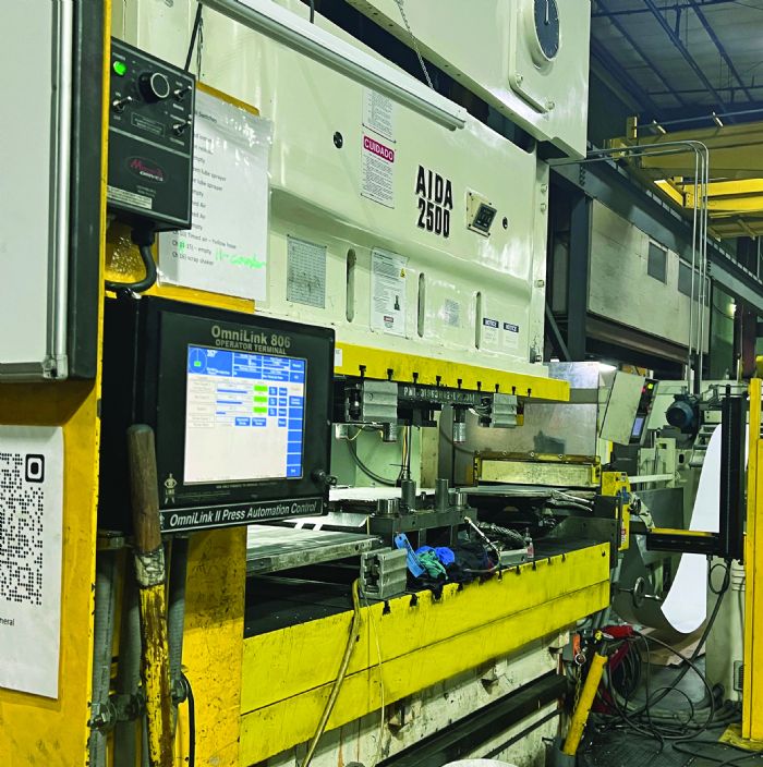

“The fault log will show many days’ worth of records on every reason a press has stopped,” he shares. “It records the reason for the stop, the job that was running, the press speed and even the exact degree at which the fault was initiated. This has eliminated the need for countless hours of troubleshooting of intermittent faults for things such as an airline flexing into a light-curtain sensing field, or a pressure switch with an intermittent fault in the contacts. Our tech walks up and scrolls back to the day and time of the fault, and immediately can narrow the issue down to one input. He then quickly can determine why that input initiated a stop—did the pressure drop, is the pressure switch failing or is there a loose wire at the switch, for example.”
Sensors and Die Protection
PMI continually invests in die-sensing technology, even installing sensors on customer tools to ensure high uptime and part quality. “The Link controls have met every sensor need we have had and, frankly, they have yet-untapped capabilities ready and waiting for us when it’s appropriate, to support a client’s needs,” Larson says.
The AMC and APC controls can run any combination of NPN or PNP sensors, N.O. or N.C. configurations, and have extensive diagnostic histories. PLSs all can have time off, input drive, toggle logic and speed advance, among other functions. Tonnage monitors provide signal analysis and the ability to automatically turn off low alarms during coil thread-up. In addition, the APC has analog-sensor capabilities, a powerful part-tracking system and even a large shift register to allow the press control to replace a PLC to power more automated dies using in-die inspection and gag tools.
Larson also notes how much team members appreciate easy setup features. “While the press controls offer a lot of high-end capabilities,” he says, “the die protection and PLS are easy to set up due to the graphical touchscreen interface displaying the stroke, timing windows and, for die protection, even the transitions of the sensors, right on the screen. Our operators and setup team can visualize their settings and receive immediate feedback showing them what is happening, which eases programming.”

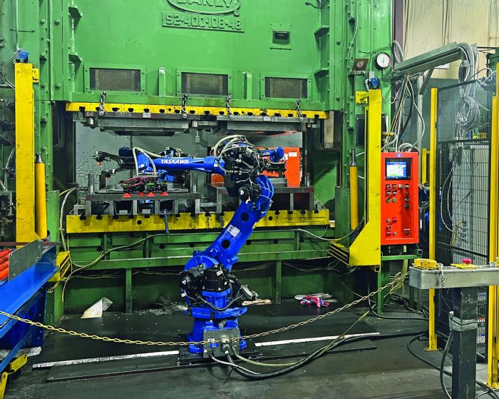

One capability of the press controls not initially used at PMI: advanced interface capabilities to support the addition of automation to the presses. “When we upgraded our first presses with the Link controls, we did not have automation on the presses,” says plant manager Eric Lewis. “When we did add our first robots to the presses, the first outside integrator we used was impressed by the fact that the control already had built-in capability specifically prepared to handle automation. As we have continued to automate our presses, this control capability has reduced the needed investment and time commonly required to retrofit automation to existing presses.”
