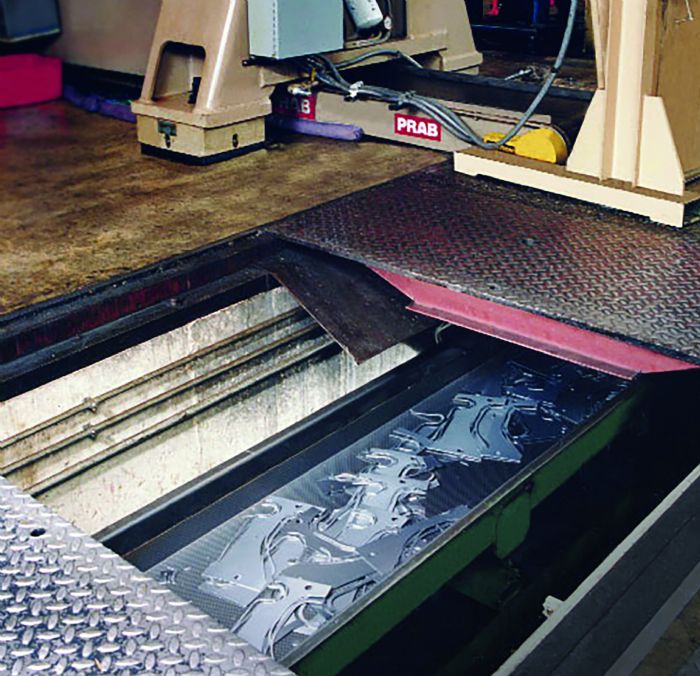

The best conveyor for a given operation depends upon the application, material type, temperature, weight, plant atmosphere and more. All of this creates a dynamic set of application criteria that stamping conveyors must be engineered to handle. In fact, multiple conveyor types often are used in combination to accomplish production goals.
One of the most important considerations: How will the material be introduced to the system? The impact of dropping material from considerable heights can damage the conveyor belt. Doing so also can cause the material to bounce on the belt and work its way inside of the conveyor, damaging internal mechanics. Impact plates, load shoes and a load bar often are necessary to prevent such damage. Also, centering payloads helps to prevent material from entering the inside of the frame.
Avoid surge loading. The best method to prevent this: interlocking the conveyor into the equipment that is feeding the conveyor. Heavy loads present another challenge. Take care to ensure that the conveyor’s pitch sufficiently can handle the weight and bulk density of the material—a must for steel-belt and pivot-belt conveyors. Occasionally, loads exceed a conveyor’s capacity, which can strain motors. To help prevent equipment damage, select conveyors with torque-limiting protection that automatically shuts the conveyors down when load exceeds capacity, avoiding damage to the conveyor.
When it comes to material movement, abrasive materials can decrease the life span of some conveyor wear surfaces. Additionally, leakproof construction will be necessary for retaining cutting fluids.

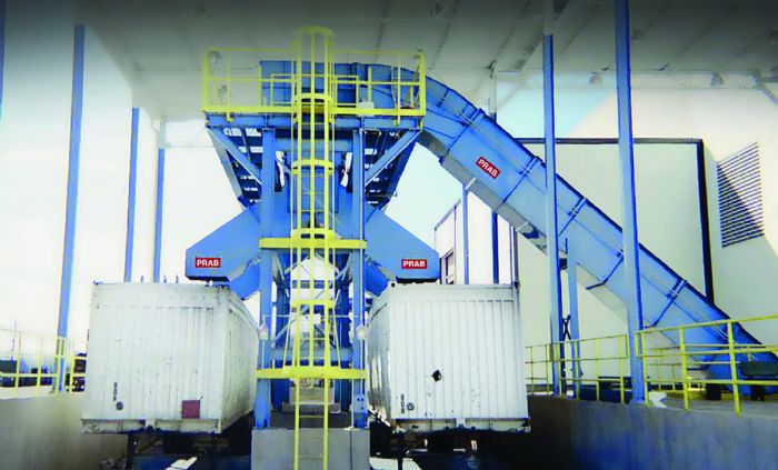

Critically important, the conveyor must be engineered to provide a clean discharge of material to avoid carryover that can require maintenance to correct. For conveyors transferring metal scrap, even distribution of the scrap into storage containers helps prevent pockets of unused space inside of the container. During loadout, this helps to ensure the maximum amount of metal scrap hauled away in each container.
