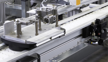

 Packaging conveyors
Most packaging conveyors are modular by design, available in preconfigured straight or curved sections that bolt together on the shop floor. They prove ideal for complex routing where assemblies and packages of small stamped parts must move up, down, and around equipment and other obstructions in the plant.
