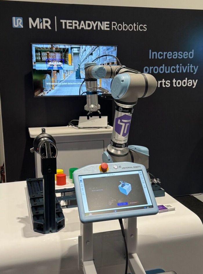

Dynamic metrology from 3D Infotech: A UR3e cobot scans workpieces, compares them with CAD models, and highlights dimensional inaccuracies by projecting them onto the workpiece surface. The AI Accelerator enhances the perception capabilities of the cobot, allowing it to more accurately locate the workpiece for inspection. - GenAI-driven programming from T-Robotics (pictured): A UR5e cobot performs CNC-machine tending. With T-Robotics ActGPT, users can describe an application setup in natural language and have it translated into a robot program with the help of the AI Accelerator.
