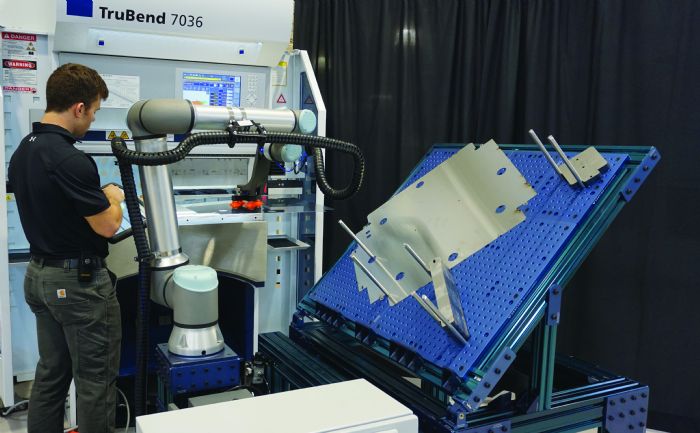

On the technical side, the most important integration issue related to press brake and stamping applications involves obtaining the correct signaling between the automation and the existing machinery.
“Make sure to employ a lot of safety protections in the cell—especially die protection,” Mayse offers. “Most companies will have integrators perform that work.”

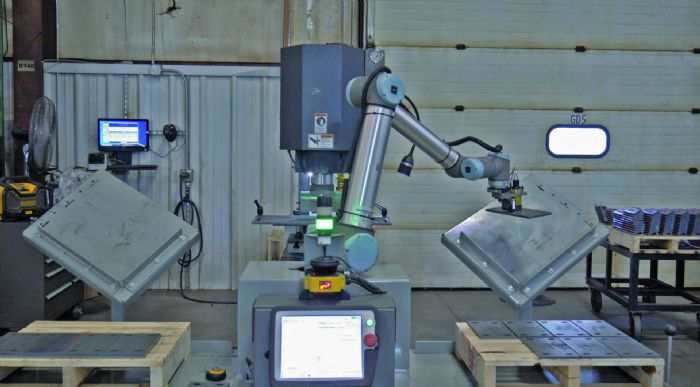

The solution involves the cobot picking a part, placing it in a stamping press, actuating the machine and palletizing the finished part. By taking over these time-consuming, nonergonomic manual jobs, collaborative automation filled a labor gap, cut cycle times in half and improved overall part quality.
