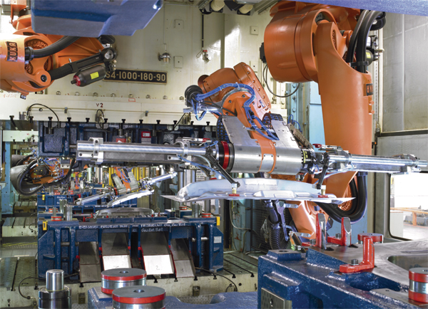

Kuka robots replaced a two-axis feeder system along this stamping line at a German automotive plant that produces body panels and structural components. The crossbar-robot retrofit dramatically increased the output of the line—by as much as 40 percent when stamping structural components and 80 percent when stamping body panels such as fenders and roof frames. |

Several crossbar robots are at work at stamping plants in China, Europe and the United States. Here we present one recent successful project involving the replacement of a two-axis feeder system with a crossbar robot automation retrofit, completed at a German automotive plant. The stamping line in question produces body panels and structural components, and the new automation allowed the manufacturer to improve transport flexibility while also increase line output. The performance improvement resulted from the ability to accurately orient the parts with three rotating axes while transferring parts between presses, as well as the highly accurate positioning of the parts in the die.
The manufacturer dramatically increased the output of the hydraulic-press line by as much as 40 percent when stamping structural components such as inner and outer B pillars and side members. In addition, throughput of body panels such as fenders and roof frames increased by as much as 80 percent (see the accompanying table).
