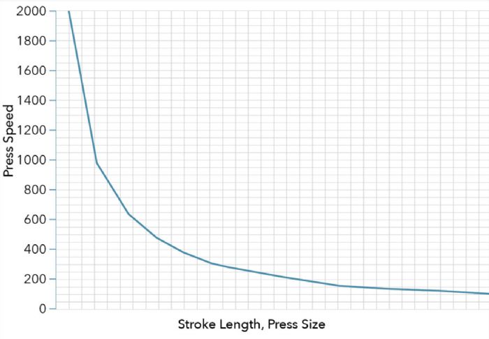

Increasing the operational speed results in notable effects. This causes increased accelerations that the press structure experiences at top- and bottom-dead centers (TDC and BDC). Concurrently, we see a spike in impact velocity, contingent on stroke length. The industry guideline is unmistakable: for optimal stamping processes, the shortest stroke always is preferred for two key reasons: curtailing impact velocity and reducing press-frame acceleration.

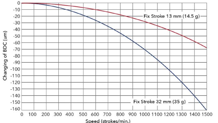

To provide empirical evidence, Fig. 2 presents data from a test machine, showcasing potential deflections in a press as speed escalates. The red and blue curves, representing presses with 13-mm and 32-mm strokes, explain the discrepancies in forces exerted on the ram drive system and the inherent deflections within the press frame. Both parameters amplify with speed.
Beyond the inherent impact energy, the press imparts vital working energy to the forming process. This energy is quantified in the tonnage rating point, a gauge of the energy on hand when operating at the standard speed. However, many high-speed stamping presses possess the ability to function at fluctuating speeds. Consequently, it’s imperative to evaluate the energy capacity at the diverse operational speeds intended for part formation, and to understand that as speed mounts, the energy allocated to each stroke diminishes. Concurrently, the energy that the press requires to operate surges, resulting in a diminished energy pool for the stamping process at peak speeds. This presents two pivotal stages: one at the lower spectrum, where flywheel energy is scant, and the other at ultra-high speeds, where the energy drain from the press-drive mechanism is accentuated, leading to a dip in the available energy/stroke.
