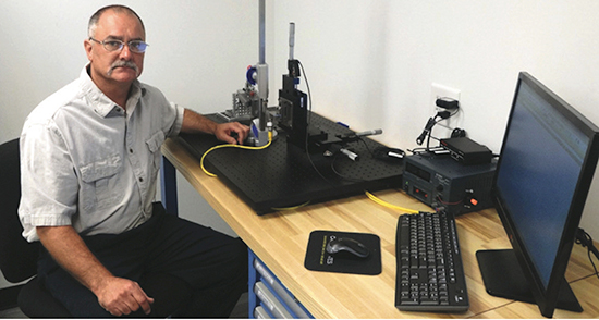

Eagle Bend Mfg. sensor applications specialist Mike Williams shows off his fully equipped sensor-testing laboratory, which includes precision positioning equipment to help him determine the exact location where a given sensor must be mounted within a die in order for it to properly and repeatedly detect its target.

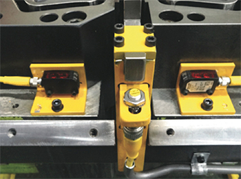

Williams prefers to use reflective photoelectric sensors (two shown, flanking a short-feed sensor in the middle) for detecting part ejection. His choice of bright yellow mounts and cabling is meant to alert others in the plant that the area has sensors within it and to exercise caution when working nearby.
With the full and uncompromising support of Eagle Bend Mfg. general manager, Ed Steinebach, the firm designed and constructed a state-of-the-art sensor-testing laboratory for Williams. The lab allows him to perform a variety of application tests required to ensure the proper implementation of sensors within tooling and assembly processes. Williams has all of the necessary equipment needed to filter through the various sensor options on his test bench. Precision positioning equipment helps determine the exact location where a given sensor must be mounted within a die in order for it to properly and repeatedly detect its target. That target can be a part or a tooling component.
Williams also uses the test bench to verify that the sensors will actually function within the die without having to mount them first in the tooling, and then experiment out on the production floor. This sensing-simulation process provides a way to investigate and innovate away from the actual tooling. Thus, when Williams is ready to actually mount the sensors in the dies he already has a very good level of confidence that the sensors will work in the pressroom, avoiding nuisance stops due to improper sensor selection and testing.

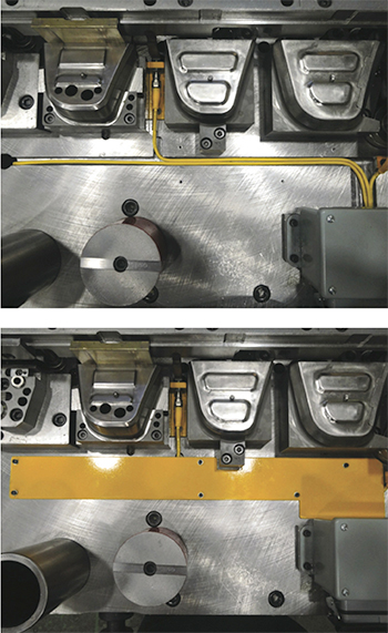

channeling and cover plates to protect sensor cables
Williams uses channeling and cover plates to protect sensor cables.
… is to, as quickly as possible, implement sensors to monitor strip feeding and part ejection. Here, Williams has developed a uniform approach to feed monitoring by incorporating an inductive proximity sensor to detect the position of a spring-loaded block that is pushed into its final, fully fed position by the strip at the end of the feed cycle. He prefers to use reflective photoelectric sensors for detecting part ejection. Note in the accompanying photos the bright yellow color, used to alert everyone in the plant that the area has sensors within it and to exercise caution working near it.
It also is the duty of the sensor applications specialist to fully test photoelectric sensors for their ability to function within an oily environment in the die. This easily can be done by spraying the photoelectric detecting beam(s) using a hand-held sprayer to ensure that the oil will not fool the sensors into giving a false output. The one catastrophic mess to avoid is to have the part not be properly ejected from the die, and the photoelectric sensors fooled into sending a false ejection signal caused by the oil droplets.

Throughout my 30 years of writing columns and articles for MetalForming on sensors, and consultations with metalforming companies of all sizes, I remain astounded as to the amount of sensor destruction that takes place in many stamping companies, whether from human error or outright negligence. Therefore, it is paramount that all sensor cabling be protected from being crushed, nicked or cut.

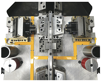

This can be done in one of two ways: machining channels for the routing of the sensor cables (when possible), or by using tubing to protect the feed sensor cable. When burying cables in machined channels, be sure to cover the channels with protective plates. Note how, once again, Williams uses yellow paint on the plates to warn everyone who will be working with the die that the area houses sensor technology.

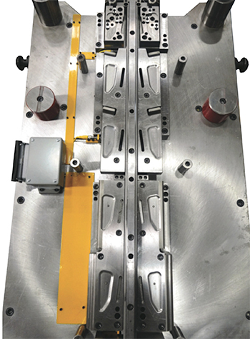

Sensor cable channels routed underneath the sensor connector box
Best practices requires stampers to centralize sensor cables into one connector. Note here how Williams routes sensor-cable channels underneath the sensor connector box. The cables then enter the box and the individual sensor wires connect to their appropriate pins on the connector.
The centralization of all sensor cables into one connector is a non-negotiable must in metalforming shops following best practices, and Eagle Bend Mfg. is no exception. Note in photo 6 how Williams routes sensor-cable channels underneath the sensor connector box. The cables then enter the box and the individual sensor wires connect to their appropriate pins on the connector.
Stampers select from two popular styles of connectors: a military-style round connector and a rectangular connector. Either way, the connector chosen must be robust and able to withstand the shocks and vibrations of the stamping environment.
