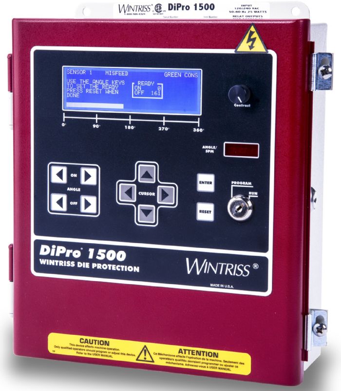

The most important factors to consider when selecting a die protection controller are capacity (for both sensor inputs and setup memory), accuracy, speed, available monitoring logic, and ease of use.

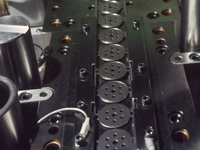

A typical progressive die needs a minimum of four or five sensors to detect common predictable malfunctions: end of material, material buckle, short feed (and possibly overfeed), and failed part ejection.
Review your die maintenance and quality control (QC) records to identify other problem areas. If you find recurring die malfunctions or quality problems, plan to install sensors to detect them also.
wintriss-sensor-connection-wiringKeep in mind that some problems require multiple sensors for detection. For example, you can detect pulled slugs by installing sensors in the bottom die under each corner of every spring stripper. Transfer operations are also sensor-intensive, typically requiring two sensors per station. Select a die protection controller with enough inputs to monitor what you anticipate being your most heavily sensored die, plus a few spares.
Ensure that the controller has sufficient setup memory to store setup information for all the dies that can be run in each press. The controller should also provide a way to conveniently back up your settings, as it can take years to create settings for all your dies.
Modern resolver-based controls are precise and fast. Resolver timing signals are typically accurate to one-third of a degree of crankshaft rotation. It is important to choose a high-speed die protection controller even if you run at low to moderate speeds. This is because some sensor actuations are short, regardless of how fast the press is running. Picture an air-ejected part flying past a photoelectric sensor. Such a sensor signal may be less than 10 ms in duration.
Ensure that the control system has the monitoring logic needed for your applications. Some sensors need to be monitored continuously to make sure they are always off, such as for material buckle; or on, such as to detect the end of material. Some sensors should have brief, momentary actuations during a specific timing window such as for part ejection, while others should stay actuated for a specified portion of the cycle. This would apply to detect material feed until the pilots have captured the strip. Still others should be monitored so that they are actuated only during certain portions of the cycle—especially sensors that monitor things such as side-action cams, transfer mechanisms, and air cylinders.
Finally, in addition to the expected failures, your control system should be able to detect malfunctioning sensors, such as when a cyclic sensor is shorted or otherwise stays actuated for an entire stroke. For example, if a part fails to fully eject, but instead “sticks” in front of the sensor, the controller needs to have the ability to determine when a cyclic sensor fails to cycle. This is often called “fail-safe detection.”

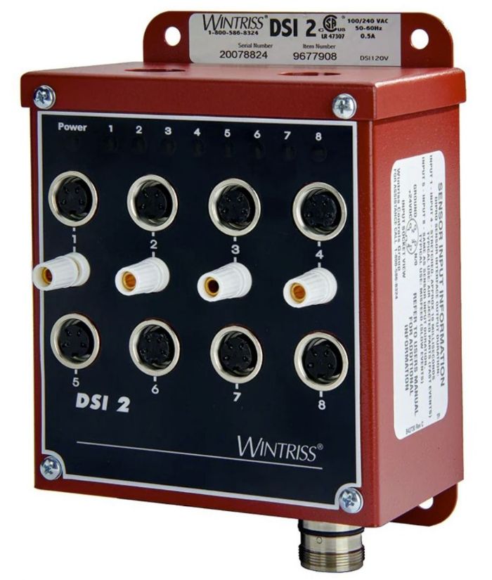

Die-mounted sensors are a different story. When a die is changed, sensors such as those detecting part ejection, misfeed, stripper position, cam return, and so forth need to be connected to the controller during setup. It is impractical to wire die-mounted sensors directly to the controller. Instead, a press-mounted sensor interface device is wired to the controller and placed close to the die area.
Typically, these devices feature connectors to accept individual sensors, as well as a master connector that enables power and sensor signals from an array of sensors to connect through a single cable. This is usually done from a die-mounted junction box. In addition to being a convenient connection point for the sensors, the interface device provides 24-VDC power for electronic sensors. It may feature pulse-stretching for short sensor signals. Also, the interface device may offer impedance-matching circuitry to enable the use of simple electromechanical sensors such as spring probes with water-based lubricants.
Importantly, something as seemingly trivial as die wiring can make or break the entire implementation process. Poor wiring practices can ruin an otherwise well-planned die protection program. There are two ways to connect die-mounted sensors to the interface device.
The first, called the traditional sensor connection method, which uses individual sensor connectors on the interface device, is troublesome. This inefficient wiring scheme requires each sensor to have a length of cable attached to it that is long enough to reach the press-mounted interface. When the die is not in use, these permanently attached sensor cables are hastily coiled up and stored with it. At run time, they are uncoiled and plugged into the press-mounted interface.
Sensors more often need to be replaced because of damage to the cables than all other sensor failure reasons combined. In addition to the possibility of catastrophic physical damage to a loose cable, it is critical to consider cable “wear.” In this context, this does not refer to abrasion, but rather, to work hardening. Most sensor wires are made from copper, which work-hardens quickly. Work hardening occurs when a metal is cold-bent repeatedly. Each time a cable is flexed, the copper wires inside become harder, more brittle, and will break inevitably. It is the repeated coiling and uncoiling of the sensor cables that will cause failure.
The traditional method of connecting one sensor at a time also is inefficient. The setup operator needs to ensure that each sensor is plugged into the correct input. Mistakes can lead to nuisance stops and die crashes.
The second, best-practice connection method is to use an intermediate die-mounted junction box to which all the sensors are permanently wired. The die-mounted box is plugged into the master connector on the press-mounted interface through a single, easily replaceable cable. This eliminates wiring errors and sensor cable wear. Standardization is important here. You should use the same setup on every die and every press.
You can purchase a die-mountable junction box, or you can make your own with an enclosure, terminal strip, and connector. Either way, be sure to select components and devices that can withstand the rigors of in-die use. If the sensors are installed in the die in such a way that they must be removed when the die is serviced, consider using a die-mounted junction box with connectors for the individual sensors. That way, you will not have to disconnect and reconnect wires on a terminal strip each time the die undergoes maintenance.
Junction boxes should be located on the die in such a way to protect them from accidental physical damage while the die is being handled. Placing the junction box on top of the lower die shoe is better than installing it on the side of the die or underneath it.
