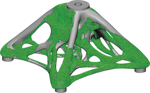

Fig. 1—The as-designed architectural bracket mimics biological structures.
Fig. 2—Topology optimization yielded solid and lattice regions.

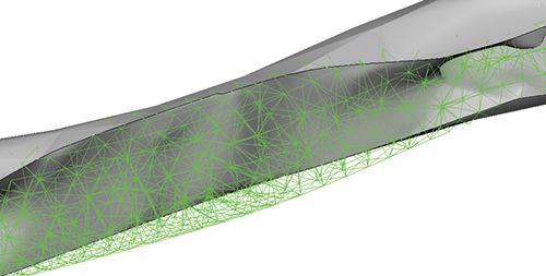

Fig. 3—An irregular interface between the lattice and solid regions adds difficulty to the 3D-printing process, and must be reconstructed.

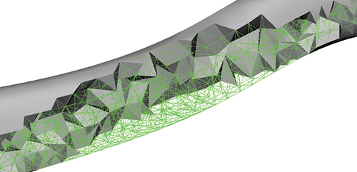

Fig. 4—Design-optimization software smooths the irregular interface shown in Fig. 3.

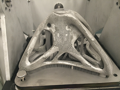

Fig. 6—By optimizing the design, a viable titanium part could be manufactured via 3D printing.

The spider bracket mimics the biological structures as one would find in nature (Fig. 1). Altair’s topology optimization software created a unique, organic shape that is both light and strong. The lattice structures also provide stability and are desirable for their thermal behavior. However, a topology-optimized model needs sufficient smoothing before it can be printed.
The topology optimization resulted in solid regions and regions with a lattice structure (Fig. 2). The irregular interface between the lattice and the solid mesh makes 3D printing difficult and can lead to stress accumulations, meaning that this interface requires reconstruction (Fig. 3). That’s where Materialise 3-matic software comes into play, according to Materialise officials. With this design-optimization software for AM, the design engineers at Materialise easily transformed the rough data into a clean model with smooth surfaces (Fig. 4).

The build file was sliced and tested according to the material parameters assigned by Renishaw. Then, the model was printed as a viable titanium part (Fig. 6). 3DMP
