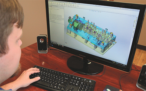

Mitchell assumed the firm’s self-improvement role in 2009, coinciding with its move into injection molding. Among his first (and most significant) process-improvement projects was tying together the firm’s design software to its cam system. “One of the biggest challenges we faced was communicating how to best fabricate specific die details. We asked Mitchell to develop a procedure for including design intent and machining requirements into our designs. Working closely with Logopress, he did just that.”
The result of Mitchell’s collaborative efforts with Logopress is the use of a fifth-place decimal on design records that indicates the process specified to fabricate a detail, “so that the toolmaker knows exactly what’s supposed to happen during die production and assembly,” says Christopherson. The firm’s cam program recognizes the extra decimal in the solid-model program and assigns the appropriate machining processes.
“This minimizes mistakes on the shop floor and further speeds the process,” Christopherson says. “Previously, our bottleneck was delivering a consistent flow of CNC programs to the shop, to keep our machines busy. Now, since machining processes are specified using our design software, that bottleneck has disappeared.”

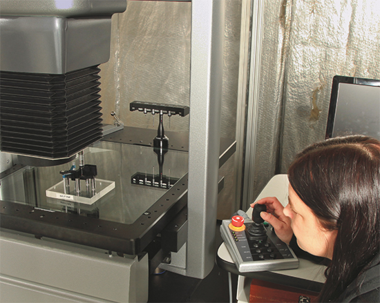

What’s Mitchell working on now? “We recently acquired a combination coordinate-measuring machine (CMM) and vision system that will allow us to quickly and cost-effectively verify block dimensions,” says Christopherson, “for our internal needs and to streamline the repair work we do on die blocks for outside customers. Mitchell is learning to program the machine offline, using the solid models. We’ll be able to receive feedback in a more timely manner and perform quicker inspections, minimizing lead times.”
