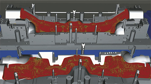

When building die sets for its metalforming systems, AP&T uses simulations and analyses done with ESI Group’s Pam-Stamp virtual-prototyping software to overcome design challenges and provide tooling on a schedule that the OEMs demand.

To ensure that customers receive ideal hot-formed parts, AP&T employs Pam-Stamp simulations and analyses. Simulations, from part design to production, can be set up in minutes and dozens of tests can be run in a day with simulation results available in minutes, according to ESI Group officials. The alternative to simulation—physical testing—is far too slow for AP&T. Setting up and performing a physical test may take two or three days plus another day or two to analyze the results.
