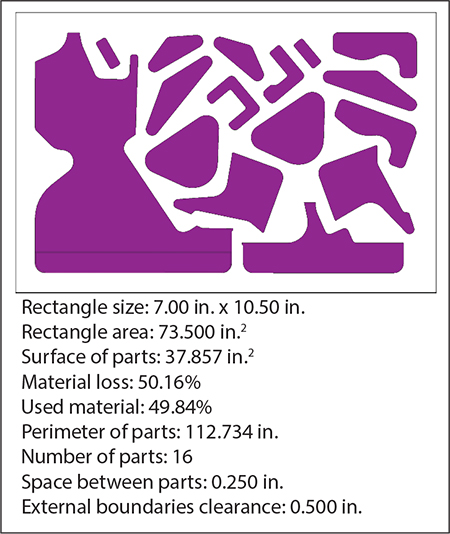

Logopress3 also recently added the ability to perform part nesting. While originally developed to nest wire-EDM punches on a common punch burn block, the feature can be used to nest shims or inserts, or even for production parts on waterjet and laser cutters.

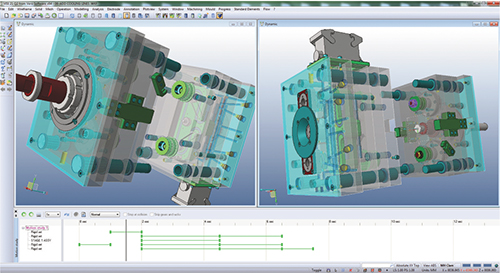

The release also includes motion-study simulation tools allowing the user to define timelines that control movement for various groups of components. With these tools, physical interaction of model geometry can be detected and the results of complex mechanisms simulated and investigated—ideal when validating tool design and checking for potential collisions with slides, cams and lifters.
VISI V21.1
VISI V21.1 also includes motion-study simulation tools, allowing the user to define timelines that control movement for various groups of components. With these tools, physical interaction of model geometry can be detected and the results of complex mechanisms simulated and investigated.

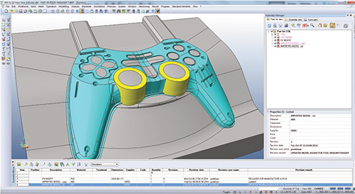

Other CAD highlights include Part Revision Management, where users can manage model changes after they have been released for manufacture. A revision history automatically generates when a model has been released with the model geometry automatically locked. Any change to a released model will create a copy of the data and update the revision number, providing a history track and ensuring that part manufacture remains up-to-date.

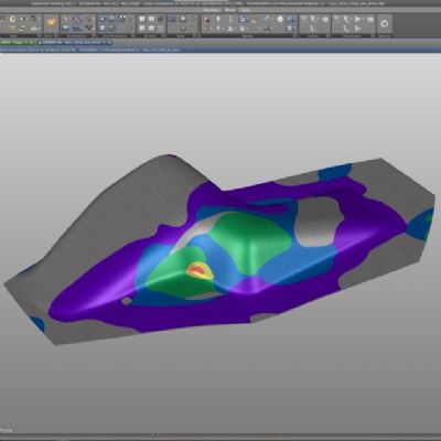

Advanced constraints in E 12’s Blank and Blank on Binder tools reportedly offer more accurate results with a new option that imitates the actual elements used in the shaping of the part, including pressure pad, draw bead, blankholder force and constrained face. And the software’s new ECO manager provides an accurate assessment and seamless incorporation of an unlimited number of engineering changes into an existing model. MF
