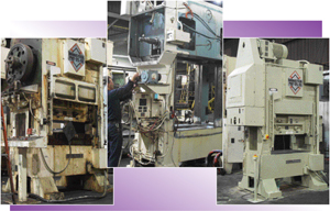

Here’s one of several Minster presses from the 1960s that were sent from a General Motors plant for rebuild and installation of new controls. |
