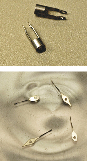

“We were stamping tiny formed parts that were post-heattreated,” he says, “and after heattreating the residual stresses in the formed parts often caused bend angles to move out of tolerance. We simply were unable to make the parts to our customer’s satisfaction. When we brought in the link-motion Yamada Dobby press, its 11-deg. dwell at bottom sufficiently allowed the release of those residual stresses so that we were able to maintain dimensional tolerances after heattreating.”
Meier processes metal strip from ¼ to 3 in. wide, with its sweet spot somewhere around 1 in. Material thickness ranges from 0.002 to 0.125 in., with a sweet spot around 0.006-0.007 in.
