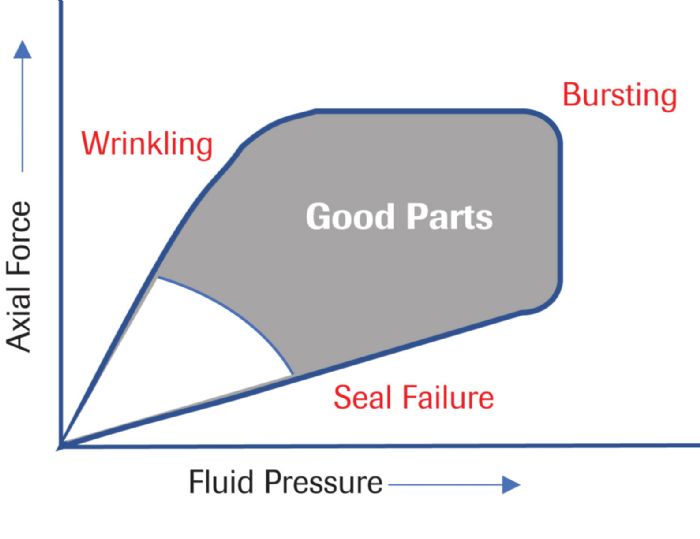

Further, without compression from the tube ends the internal pressure needed for tube expansion also would lead to thinning. In contrast, insufficient internal pressure results in wrinkling of the tube wall during axial compression (see the accompanying figure showing the balance between axial force and fluid pressure).
The internal pressure profile plays an important role in determining product characteristics. One approach is to use high-pressure hydroforming (HPH) where a hydroforming die fully closes on the starting tube before it fills with fluid. With no internal resistance present, the die crushes the tube walls in some areas, while the cross-sectional corners are farther away from the die cavity. As pressure increases, the regions in contact with the die have limited movement and, therefore, do not thin or strengthen from work hardening. However, adjacent regions are free to move, leading to strain concentrations. The greatest stretching occurs in the corners where the high pressure forces the tube material to reach the corners, thus strengthening and thinning those regions. For parts having a minimum thickness requirement, counteracting the corner thinning may require starting with a thicker tube. The HPH process, because it creates stretch deformation, is sensitive to the n-value of the starting tube as well as the changes occurring during forming.
Corner radii, n-value and thickness uniformity are not issues in the related pressure-sequenced hydroforming (PSH). Here, increasingly pressurized fluid fills the tube as the die closes, providing internal pressure to resist crushing and other surface deviations. The die-closing action further augments the fluid pressurization. Expansion occurring simultaneously throughout the tube minimizes localized thinning so that final wall thickness is close to that of the starting tube.
Certain product features can limit the feasibility of using tube hydroforming. For example, axial compression works only if the pre-bent tube and the targeted part shape have only a limited number of bends. Tighter bend radii generate higher strains on the outer surface from geometry alone, and while pre-bending helps, this operation consumes some of the inherent formability of the initial straight tube. The hydroforming pressure increases in direct proportion with the component’s smallest radius, leading to potential tradeoffs between design and equipment capabilities.
