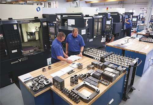

Feintool’s success in adopting high-precision hardmilling capabilities has been based not only on its acquisition of new machine technology but also on the knowledge and experience of the company’s engineers who have become more innovative in their processing techniques. As part of the company’s continuous-improvement initiative, engineers recently took aim at maximizing machine-utilization rates by increasing annual cutting hours on each V33i from 4500 to 6000/yr. By increasing cutting time on the V33i machines by 1500 hours annually, the company was able to achieve necessary production capacity without investing in a fourth VMC.
According to Andres, Feintool engineers are continuously evaluating new process optimizations to get the most out of machine investments, including programming refinements, cutting-tool selection and improved workholding solutions. One example is the recent adoption of magnetic worksholding. With previous clamping methods, Feintool was limited in the number of tools that it could machine in a single setup. By switching to magnetic workholding, engineers now can maximize space within the work envelope to optimize productivity.
“Once we adopted magnetic workholding and began performing longer runtime setups, we were able to get even more value and return from our V33i machines,” says Castle. “It enabled us to fully take advantage of the machines’ rigidity, thermal-control features, broken-tool sensors and expanded tool changers. Today, we reliably run setups for upward of 12 hr. of continuous cutting with small-diameter endmills, maintaining 10-micron repeatability throughout.”

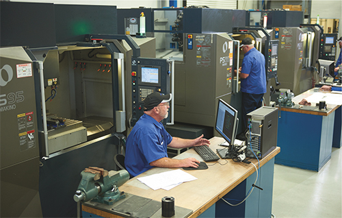

In addition to its advancements in hardmilling processes, Feintool also has made significant investments in its preheattreated-machining capabilities through the acquisition of three Makino PS95 VMCs in 2014.
Prior to these investments, Feintool had been outsourcing most of its preheattreated machining processes. Some preheattreated machining had been processed inhouse on a set of older mills that struggled to handle the forces necessary to perform heavier cutting operations. To reduce lead times, decrease costs and gain more control over the tool-making process, Feintool decided to invest in internal machining capabilities.
“The PS95 machines are workhorses that do an exceptional job of heavy cutting, and in a pinch can even support some of our finishing processes in hardened steel,” says Andres. “Through these acquisitions, we’ve been able to eliminate $500,000 each year in outsourcing, enabling us to pay off all three machines in just one year.”
Today, Feintool’s preheattreated-machining processes are performed faster and with better quality, according to company officials. This performance has enabled the company to not only reduce lead times for customers but also expedite prototyping processes to help customers get products into market faster.
