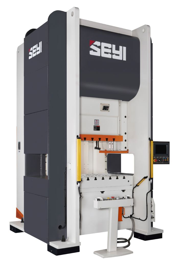

Seyi-America, a global supplier of stamping presses, showcases its servo technology and new offerings, with visitors able to view and operate an SD1-220 direct-drive servo press. The SD series is productive, efficient and simple to program, offer company officials, enabling metal stampers to optimize production. The press is equipped with an inhouse-designed servo motor, seven default motion profiles, a Free Motion fully programmable profile and electronic overload protection to prevent over-tonnage conditions. The SD series is offered in capacities from 88 to 550 tons.
Additionally, Seyi debuts its new Allen-Bradley control package for servo presses. The control features Allen-Bradley’s Compact GuardLogix PLC, 12-in. color touchscreen, 200-job recipe storage, eight-input die protection with interface box, 15 programmable outputs and integrated tonnage monitor. Seyi now offers Allen-Bradley controls on all of its press series.Technologies: Pressroom Automation, Stamping Presses
