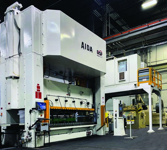

The firm’s investments in larger presses reflect growing demand to stamp high-strength steels and larger parts, Thompson says. Of its 70 presses, the largest are located in the company’s Kentucky plants. These include two 1100-ton presses, two 2000-ton presses and two 2200-ton presses with 300-in. beds. “You can do a lot with 300 in. of bed length,” Thompson says. “It allows for bigger tools and bigger parts.”

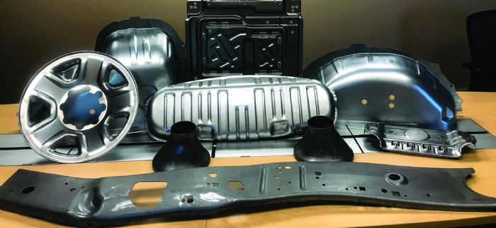

Big-Rapids-stamping-stainless-steel-automotive-componentsThe company also recently purchased a 600-ton PTC progressive-die press in preparation for continued demand and growth. “We needed a press for future business,” Thompson said. “The past 12 to 18 mo. have been very busy.”

Siple and Thompson profess vigilance when it comes to ensuring that the company has enough equipment and space capacity to take on new work. Timing is not always easy: a large, new press installation can take as long as 2 yr. to complete, Thompson says.
“We are proactive,” Siple explains. “Our team has a formula that we review every week. We look at sales projections and how much we can add safely. When we have new equipment and space, more work comes in. With our square footage and full stable of presses, we are in a prime position to take on more customers without capacity restrictions.”

The markets the company serves, and the sheet metal grades it forms, have evolved dramatically during the last 4 yr., according to Thompson. “We now have new customers in new markets with different products,” he says. “We primarily had stamped stainless steels in our early days, and over time have brought on carbon and galvanized steels, AHSS, and most recently aluminum products.”
With its newer, larger presses and new Kentucky plant, Big Rapids has been able to expand into new, non-automotive markets. “Automotive used to comprise 99 percent of our customer base. Now it is about 70 percent,” Thompson shares. “We have gained new business and customers through our expanding facilities and capabilities.” Such diversification, he explains, has provided balance to the instability that comes with relying heavily on one industry segment.
In addition, the firm has diversified within the automotive segment by supplying components for electric vehicles while still supplying parts for combustion-engine-powered vehicles.
