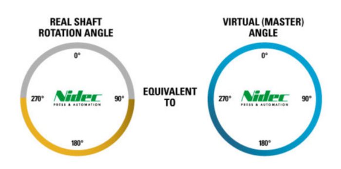

To ensure proper function of all systems linked to a servo press, we use a real and a virtual angle. The real angle indicates the angular position of the shaft at a given moment, while the virtual angle is a constant-time-based representation of the complete motion profile. For example, a production rate of 60 strokes/min. will take 1 sec. to complete a full revolution, 0 to 360 deg., of the virtual angle, even though the real angle may accelerate, decelerate or change direction during the stroke. The press controller performs this conversion automatically.
The virtual angle indicates how far in time the motion profile is from completing a stroke. Consider the real angle oscillating between 90 and 270 deg. with the servo press operating in pendulum mode. In the forward stroke, the virtual angle will automatically be set in such way that 0 virtual deg. corresponds to the initial pendulum angle, 90 real deg., and 360 virtual deg. corresponds to the final pendulum angle, 270 real deg. (Fig. 2). If we add acceleration or deceleration to the motion profile, a virtual 180-deg. angle would not necessarily mean that the press is at BDC. Instead, it would indicate that the slide has moved half the time required to complete a stroke. The use of virtual angle opens an infinite number of possibilities for synchronization of ancillary equipment and other external actuators.

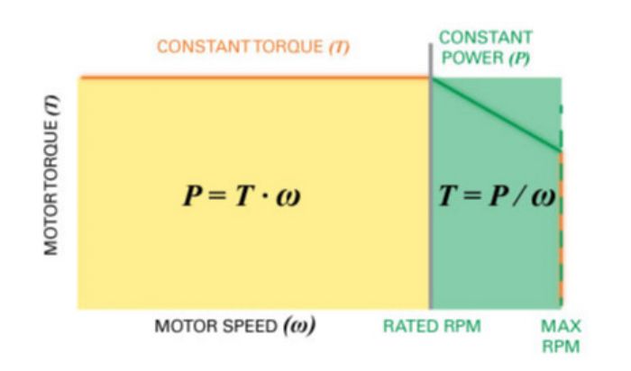

Due to electric principles beyond the scope of this article, the torque available in a servo motor peaks and remains constant up to a rated speed, but decreases at a constant power rate above such speed (Fig. 3). This behavior has positive and negative connotations. On one hand, servo presses would outperform conventional presses for applications requiring full capacity at low speeds—die setup, for example. And, conventional presses will perform best for applications requiring full torque at maximum speeds.

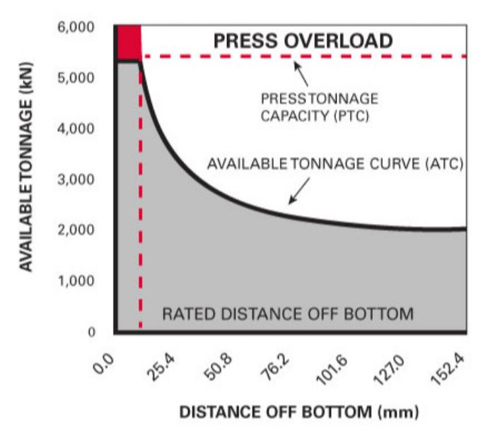

As mentioned, the available tonnage is related to the torque available within the system. For constant torque, in a slider-crank press the available tonnage will increase with decreasing lever-arm length. In other words, for constant torque, available tonnage increases with decreasing distance off bottom (DoB), as described by the available tonnage curve (ATC, Fig. 4). Looking at the ATC, the minimum tonnage available occurs near the halfway point in the stroke, while the maximum tonnage available (or press tonnage capacity, PTC) occurs at the rated DoB. Theoretically, the available tonnage could reach infinity at TDC or BDC, where the lever arm is zero. However, that would compromise the press structure at tonnages beyond the PTC and it should be avoided.

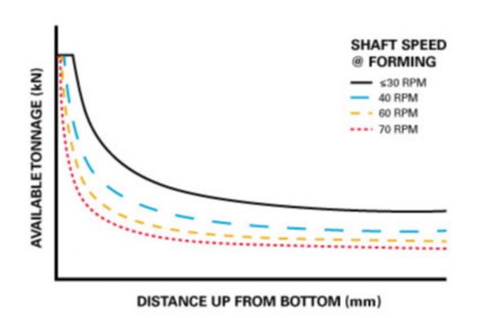

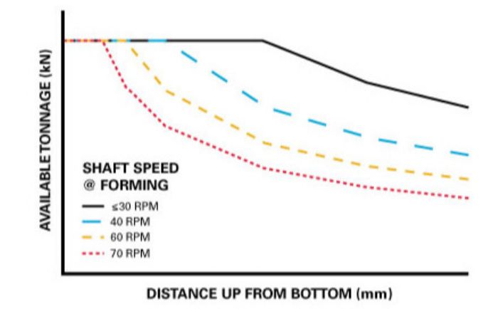

If the available torque changes, the ATC also will change, and so it’s important to understand the differences between the tonnages available in a conventional press compared to a servo press. For practical purposes, we can say that in a conventional press, the ATC does not change with shaft speed within the operational-speed range. Conversely, the ATC of a servo press is scaled down as we exceed the rated speed (Fig. 5). This results from the decreased available torque above rated speed in servo motors. Torque reduction in the servo motor also leads to a decreased rated DoB above the rated speed (Fig. 6). When looking at the ATC in a servo press, do not confuse shaft speed and production rate. Shaft speed refers to the actual rotational speed of the shaft, while the production rate refers to the number of parts being produced per unit of time.
In many cases, this scaling-down-of-ATC phenomenon does not represent a significant disadvantage for servo presses, as many jobs do not require maximum motor torque. For those that do, we can decrease the shaft speed during forming in order to have full tonnage available. And, increasing the shaft speed during the nonforming portion of the stroke would help to maintain the production rate as high as possible. Nonetheless, take care to understand the ATC versus shaft-speed variation with servo presses.

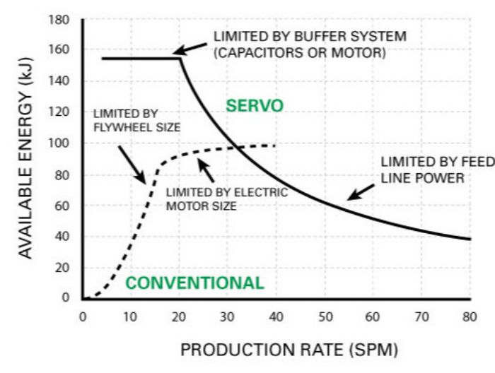

The power supply of the press dictates the energy available per unit of time. Conventional and servo presses employ different systems to store energy, and due to these differences, conventional and servo presses show opposite trends regarding energy available at low and high production rates. Again, do not confuse production rate and shaft speed.
In a conventional press, the energy available depends on the size and speed of the flywheel, and the size of the main drive motor. As the flywheel rotates faster, the amount of stored energy increases. This energy is consumed during the forming process and replenished by the drive motor during the nonworking part of the stroke. The faster the speed, the less time the motor has to restore the energy, thus the system is limited by the power of the drive motor and its ability to restore the energy in time. The available energy curve (AEC, Fig. 7)) captures this behavior, relating the energy available to the production rate.
In a servo press, the energy flows directly from the electrical supply line to the storage devices, and then to the servo motor. The capacity of these storage devices determines the maximum amount of energy available during forming. Starting at low production rates, the full amount of energy is available as there is enough time to replenish the storage system to its full capacity, an advantage over conventional presses. Once the replenish time becomes insufficient, the energy available starts to decrease above a threshold determined by the size of the electrical supply line and capacity of the energy storage. Due to the storage capacity of modern devices, servo presses typically have larger amounts of energy available. This makes servo presses more desirable than conventional presses when dealing with high-energy consumption applications.

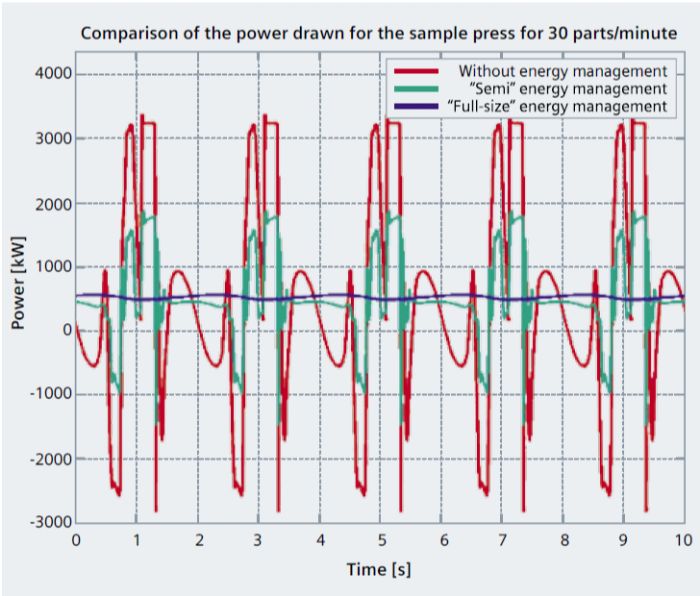

Different energy-management systems exist for servo presses, depending on how the system delivers energy. Delivering the required energy directly through the servo motor does not require energy management. A semi energy-management system delivers energy by the motor and the storage system. And, a full-sized energy-management system provides all of the energy required in the storage system.
Applications implementing some level of energy management will experience a more uniform power demand from the grid, resulting in lower peaks (Fig. 8). Moreover, an energy-management system will reduce the power pulled from grid and the size of the transformer required, while increasing the efficiency factor of the energy used. On the other hand, these setups will increase the number of electrical components in the servo press, which can complicate maintenance procedures. In general, however, the benefits of an energy-management system overcome any maintenance concerns.
