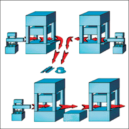

Many stampers run coil and blanks in the same press, and some transfer-press systems deal efficiently with both conditions. The physical characteristics of the transfer system, along with the flexibility of the electronics, allow press lines to load blanks in one direction, and then run coil from the other direction. MF

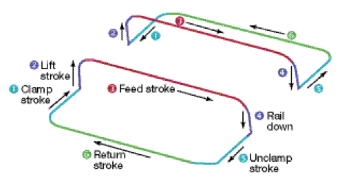

Guide-pin or heel-block locations. Traditional die-design principles suggest that pins or heel blocks be located as far outboard as possible (Fig. 1). This allows for the longest lever arm between the contact points, keeping the upper die parallel with the lower die during operation. This works well with progressive dies, which contain all motion inside the die, or with line dies, which allow the operator to work between the die pins. But with most transfer systems, this front-to-back location results in a longer clamp stroke—due to a finger return path located outside of the pins—and a slower transfer speed. Left-to-right pin locations usually are dictated by part and die size. Efforts typically are made to orient the part with its minimum dimension in the left-to-right direction (direction of flow) to obtain the required number of stations in the press and to maintain a minimal stroke distance. For a large press producing small parts, the dies may have to be oriented close together in the center of the press—with the loading system if feasible—or idle stations may need to be added to keep the stroke short.

Lower die profile. Rather than run the movement of the transfer with square corners at the transition of lift motion and stroke motion, most servo transfers can round the corner—essentially overlapping between the two motions. This is possible where no interference exists between the fingers or the lower surface of the part and the lower die. More clearance allows greater overlap, creating a larger radius and making transition from lift to stroke smoother and faster, increasing output.

Finger return path. Critical for transfer-die design, clearance between fingers and die components during the return stroke of the transfer must be analyzed to ensure no interference. Clearance issues for mechanical transfers are even more critical, as servo transfer systems can vary the return profile of the fingers, allowing more clearance possibilities.
All of these suggestions save time by reducing travel distance of the fingers, beginning transfer motion early in the cycle, or rounding the corners of various motions (Fig. 2). At a fixed press speed, these improvements slow finger motion and reduce the chance that part control will be lost.
