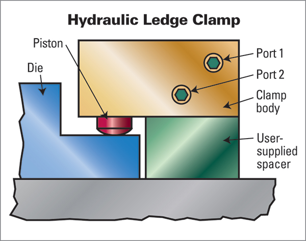

Hydraulic Ledge Clamps
Fig. 3—Sliding clamps install easily in existing T-slots without bolster or ram modifications. Typically, 0.157-in. clearance is provided between the retracted pistons and the die-clamping surface. The hydraulic piston is a single-acting spring-return type; hydraulic pressure is applied through a standard port fitting. |
…prove popular for new and retrofit applications. The clamp body (Fig. 2) and user-supplied spacer block fasten directly to the press ram or bolster by cap screws. As many as six (or more) individual spring-return pistons are available in this design. Hydraulic fluid flows through internal drilled passages, minimizing the need for external hoses and piping and eliminating potential sources of leaks.
For additional safety, ledge-clamp setups can be supplied as a split system supplied by two individual pressure sources. Some designs are supplied with hydraulically controlled check valves that require separate hydraulic pressure to release the clamp. The hydraulic ports are shown in the clamp body.
The clamping surface on the die shoe or subplate must be of a standard height to permit interchangeability with a variety of dies. The standard clamping height chosen determines the thickness of the user-supplied spacer block. Typically, 0.50-in. clearance is provided between the retracted pistons and the die-clamping surface. Each application requires individual evaluation. Ledge clamps that are bolted in place must provide ample piston-travel clearance in excess of the lifting stroke when using bolster roller lifters.

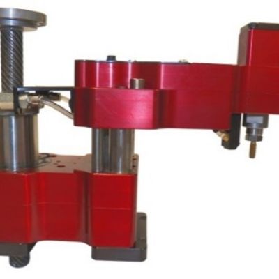

Automatic Traveling Die Clamps
To enable automatic die change in transfer presses and tandem lines without the extra expense and weight of an adapter plate measuring the width of the press ram, stampers can opt for automatic traveling die clamps (Fig. 4). Shown is a complex automatic die-clamping system attached to a press slide. An electrical motor with a gear head drives the mechanism that positions the clamp. With the die in the press, and the press closed, the motor drives a flexible track with a clamp on the end into position to clamp the upper die in the press. While these systems can be expensive and somewhat complex when compared to a clamp that simply slides or swings into position, they prove very cost-effective in applications where operators struggle with hand-positioning clamps on large presses. Here, die-setter safety alone can justify the cost of the system.
It is essential to have a locating-pin system position the die clamping slots in alignment with the traveling clamps. Again, the purpose of the traveling clamp is to avoid the need for a subplate the width of the press ram for each die. The traveling clamp will engage and secure milled pockets in the upper die shoes.
The example shown (in Fig. 4) uses an electric motor and a gear-reduction drive with a sprocket system driving a rigid chain to move the clamp. Other positioning systems may use leadscrews or belt-drive methods. Designs use hydraulic or electric clamping. The power source to move the clamp into place may be an electrical motor, air motor, hydraulic cylinder or air cylinder.
