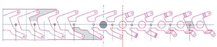

1-Eight-Station-Die-Tipping-Moments-Tooling-By-Design-Ulintz-April-2025Dies—particularly progressive and transfer dies—generate other types of forces that can cause the press slide (ram) to tip to one side, resulting in an out-of-parallel condition inside of the die. These forces, called tipping moments, produce off-center loads that can affect part quality and damage tooling if not properly managed.

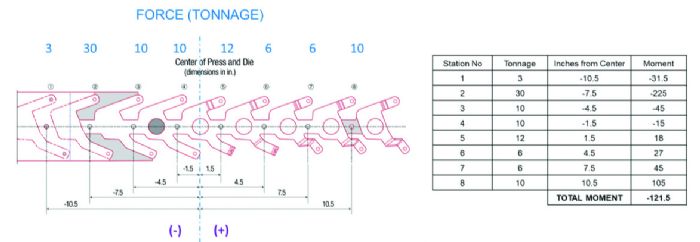

Tipping moments in a die are calculated by multiplying cutting and forming forces for each die station by their distance from the center of the press. Using the center of the press as the origin (zero), assume distances to the left have negative values while distances to right are positive, like a number line. In a perfect world, the sum of all of the moments would total zero, indicating that the center of the die load is balanced at the center of the press.
2-Ten-Station-Die-Tooling-By-Design-Ulintz-April-2025Now consider two progressive die strips (Figs. 1 and 2). At first glance, the eight-station layout in Fig. 1 appears to be the best choice. Fewer working stations mean a less-costly die, and elimination of idle stations provides a shorter die length that may allow the die to run in a smaller press. However, when calculating the tipping moments for each die station, the die in Fig. 1 produces a -121.5 in.-ton moment. The negative value indicates the center of load residing to the left of the die centerline. These tipping forces can compromise part quality and die life, and in the worst-case scenario, exceed press capacity. Conversely, the  revised 10-station layout in Fig. 2 produces a total moment approaching zero, but at a higher tooling cost.
